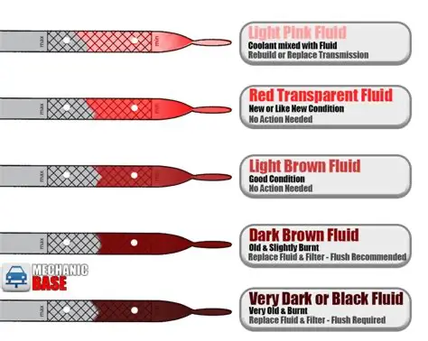

Not really low power, the engine seems to run fine it just may need a tune up. It just seems like pulling away from a stop sign isn’t like it used to be. Almost like a little stumble upon acceleration. But put the truck in park and give it some revs it seems okay. How would I check for burnt fluid? Smells? Color? Taste? Lol.

dont taste it ;)
if it seems fine in park i wonder if its just the trans slipping and reengaging off the line? not too much of a trans guru, just going off of what i now. could also be low fluid, see where it is on the dipstick when hot. i wonder if its just old/low fluid causing all of this. any whining from the trans? hppefully someone else chimes in too to sanity check me.
dont taste it ;) View attachment 430613if it seems fine in park i wonder if its just the trans slipping and reengaging off the line? not too much of a trans guru, just going off of what i now. could also be low fluid, see where it is on the dipstick when hot. i wonder if its just old/low fluid causing all of this. any whining from the trans? hppefully someone else chimes in too to sanity check me.
