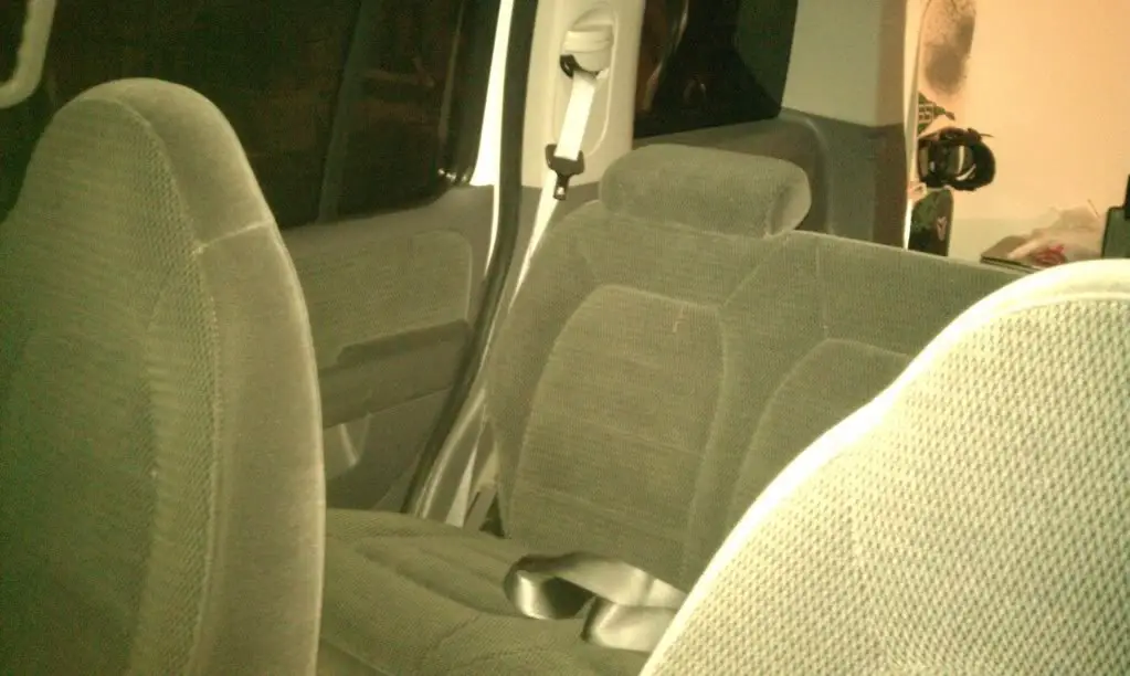

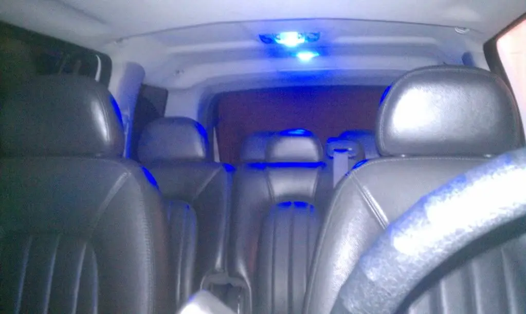

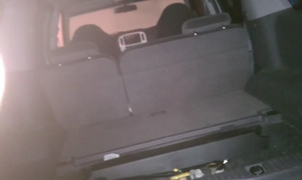

i swapped my entire interior while adding a third row. Here are my pictures
Before:
After:
all of the mounting holes were already in the body of the truck so the third row seat and seat belts are secure. One thing i was told is that the NON 3rd row explorer body had an incline towards the back, where as the FACTORY 3rd row bodies were relatively flat, meaning that your 3rd passengers will sit with their heads slightly closer to the roof

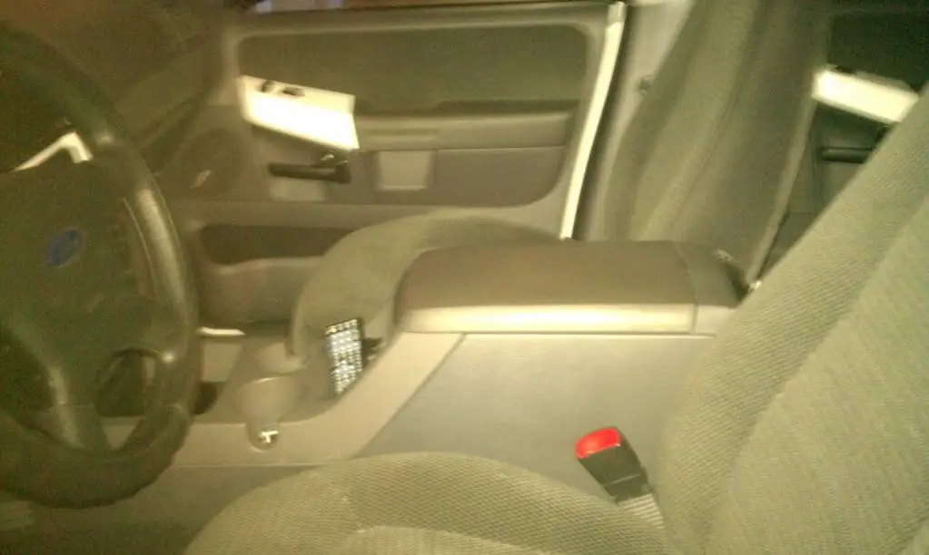

I have manual controls with stock 2nd and 3rd row air. Here is what mine looks like.
Dash
Front
