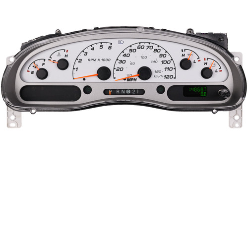

My explorer i've had for awhile now.But the last year have had dash problems!It runs great not problems.The is the gauges go out and all the windows don't work and radio.RPM will only work and when gauges do work so will all the rest.But only a few gauges at a time will work or freeze in spot.Odometer says"test".Dome lights come on througth the night,also the radio.Woke up too dead truck afew times.Almost had enough!!

Mine has the same issues, did you ever find a solution? Mine is a 2005
The instrument cluster in the 05 is a one year item and it can cause serious electrical issues
We have discussed this quite a bit here on this forum recently
You can purchase a used one
Or attempt to have yours repaired
