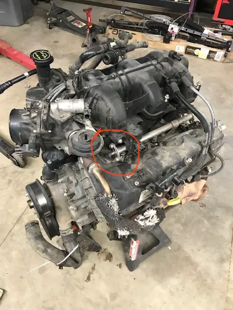

Here is a 4.0 sohc engine from a 06 ranger
I circled the fuel rail pressure test port

All great advise and testing the fuel pressure was on the list of things to do. The problem I had was the fuel rail did not have a schrader valve on it like the engine pictured above. It just has round caps at the end of each one (looks like no port to test on). I did some research and it seems you may have to somehow tap into the fuel line as it comes up the firewall, but I admit I am not sure how to do that yet. I have never had a vehicle act like this. Barely starts, won't idle, you can get it to move........but you need to mash the pedal to the floor and even then the truck is not happy. I also should have mentioned when I pulled the plugs (the old ones) they were very black and smelled like fuel.
Yep
On some 4.0 the shcrader valve is on passenger side rear of the rail, near the firewall… worth a check
If it doesn’t have one then they expect you to read the pressure with your scanner
Or
Plumb in a manual gauge with a tee fitting…. Not easy when the fuel line comes up the back of the engine on the spine of the transmission…… and not easy when we are dealing with 64 psi and spring lock fittings

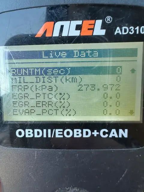

I think so. I went out there just now and I saw a description on the scanner that said FRP (kPa) (I assume fuel rail pressure). I looked at that and it said 273.97 kPa. I am pretty sure when I did the conversion that this translates into 39.73psi. To be clear, all I did was turn the key to the start position (I did not start the truck) and that is what I got. Any thoughts? I included a picture from the scanner below.
Also, I forced the truck to start and read the live data. It ranged from the high 250's (kPa) to about 284 (kPa). This was mostly with my foot on the accelerator trying to keep it running. When I took my foot off the accelerator, the truck would hold for a little while around 270 (kPa), then eventual it would start to shake and the kPa would drop to 260's 250's and stall out.

As an update if anyone is following this, I have replaced the fuel pump and the fuel filter this weekend (Bosch Fuel Pump) and Motorcraft fuel filter. Unfortunately the problem I have still exists? As mentioned, I have replaced the coil, wires, plugs, 02 sensor, fuel filter, fuel pump and this issue is not resolved. I will say that using my scan tool and not starting the truck (just turning the key forward), the FPR (or fuel rail pressure) seems to be closer to 500 (as opposed to the 273 mentioned above. However, when I start the truck and look at the live data, the fuel pressure per the scan tool seems to drop to 260 / 250 kpa and will only run if I step on the accelerator? The only other thing I can think of is the fuel pressure sensor? I am pretty stuck here so if anyone has any ideas, please let me know. I can use the help. Also, there are no other codes (which is not helping either).
Very good work!
I’m so sorry throwing fuel parts at it is now helping dang
Not easy to change fuel pumps
I’m going to do some research about the fuel sensor and your readings will report back (this system still new to me)
