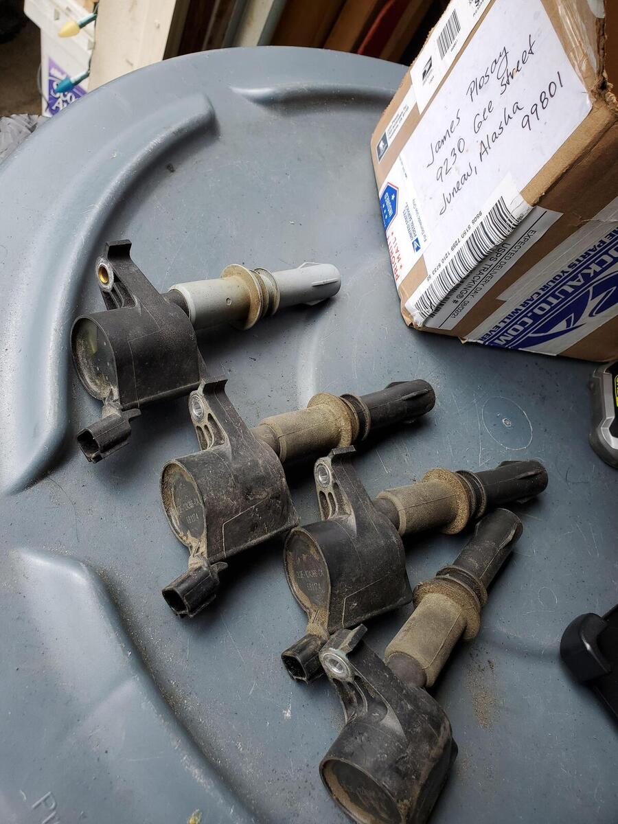

Finally got my other ignition coils in, all Motorcraft parts. Priority Mail 2-3 day shipping ..... try 2-1/2 weeks to Alaska. Anyway, installed the Motorocraft coils in the rear 4 cylinders, and moved the Delphi new coils to the front two cylinders on each bank. An odd discovery is that on the driver side, all the old coils were Motorcraft except this odd grey-boot generic coil (no name, no p/n, nothing marked) which was on the rear-most cylinder on driver's side bank, cylinder #8.
