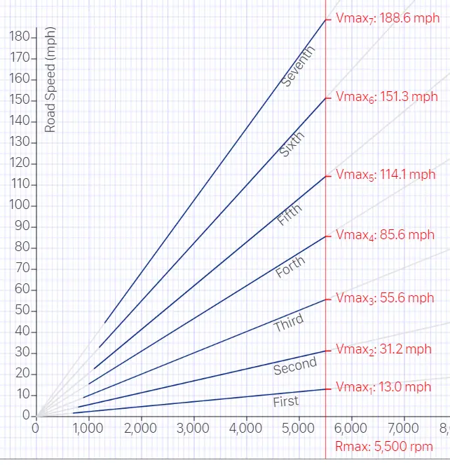

As it stands, this is the gear chart for the 4th gen with the 4.6 and the 6 speed with 3.55 gears (stock) and stock size tires.
Please note that first gear is NOT first gear. It is first gear in 4lo. I include that to show what you get at the lowest edge of capability.

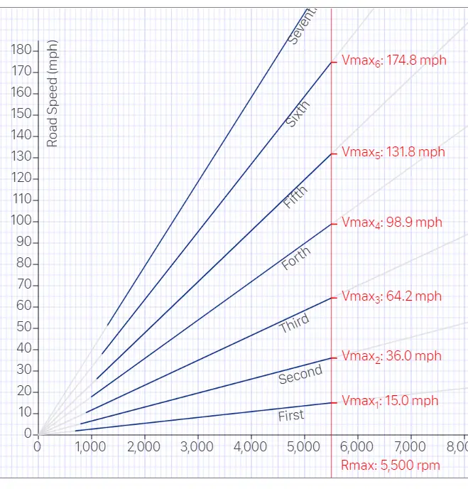

Below, this is a graph of a stock truck with 32.6" tires. As you can see, this combo gets pretty out of hand and really pushes what one could expect to do and not feel as if they messed up badly.

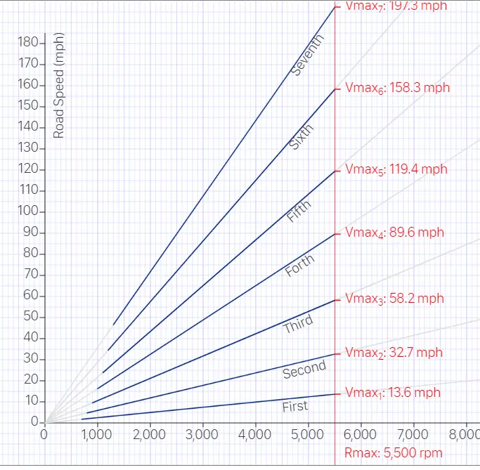

So, what happens if we change the ratios in the diffs? I am glad you asked! Thats what we are here for right? Below is what you get with a swap to 4.10 and 33" tires. I picked this as I feel its sort of a happy medium in that some people may want to run a 35" or maybe go to the steeper gear but this is pretty close to what you will get with a ratio swap with big tires.
This ratio and tire choice will give pretty good off road gearing while still letting you sit at around 70mph cruise at just over 2000rpm in top gear. Thats not too shabby. I would likely go to something a little steeper for better off road as a 4.56 with this tire still comes in at around 2350rpm cruis but that is likely just high enough that it may annoy some.
