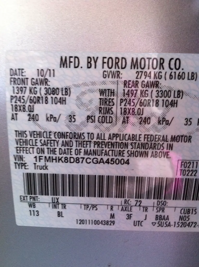

I am demo'ing a 2012 Ford Explorer XLT 4x4. The dealer has assured me that I have a towing package minus the hitch. Part of the deal is that they will put a hitch on her and I'll be able to tow 5,000 pounds.
However, I do not see a tow button that would lock out overdrive. This raises a brow and I am not sure if my dealer is being completely honest. I am getting what I think is a good deal so I want to just see if I am being paranoid here.
According to this here are the explorer towing capacities for 2012:
https://www.fleet.ford.com/showroom/rv_trailer_towing/2012/12FLRVTT19_ttselectorP23_Sep6.pdf
Here is a sticker on the door.
Anyone know what I can really pull here? Do I need the tow button or should I just kick it into manual and shift it myself?
Wish I could trust people these days! Any help is appreciated.

I've got the 2013 Sport with the tow package. Look below the light switch on the left of the dash. You should see a button labeled "tow". If you look under the car, you should also see an air duct for transmission cooling.
I think your dealer is lying. If it comes with a tow package, it comes with the hitch, wiring, and tow/haul button installed.
Take a look at the window sticker. There should be a Trailer Tow Package listed under the options.
Walk away and find another Explorer.

Hi astyles,
Here's the window sticker for that particular Explorer: http://fordlabels.webview.biz/webviewhybrid/WindowSticker.aspx?vin=1fmhk8d87cga45004
As you can see from the document that you linked to, there's quite a bit of difference between the maximum loaded trailer weight depending on whether or not the vehicle has been equipped with the Trailer Tow Package and weight-distributing hitch.
Crystal
No tow package on that vehicle based on the sticker. Trailer sway control is NOT the tow package with the hitch, oil cooler, etc.

What's to confirm? The sticker doesn't show trailer tow, and the Ford rep confirmed it. It doesn't have a trailer tow package.
That said, you can still tow with it, but not at the full capacity that requires the trailer tow package.
And the Tow button does more than change shift points. It does lock out the overdrive.
I'd find a new dealer.

Along with these comments, any tow hitch you would add would go below the rear fascia instead of having a removable cover so the hitch is better in line with the frame. The tow package comes with a removable door to acces the hitch in the rear fascia. The non-tow package does not.
That dealer / salesman is flat out lying to you if he's telling you that you can tow 5000 pounds with this vehicle. The max you'll be able to tow with that particular Explorer is 2000 pounds if they slap an aftermarket hitch on it. I'd find a more honest place to deal with if I were in your shoes.
