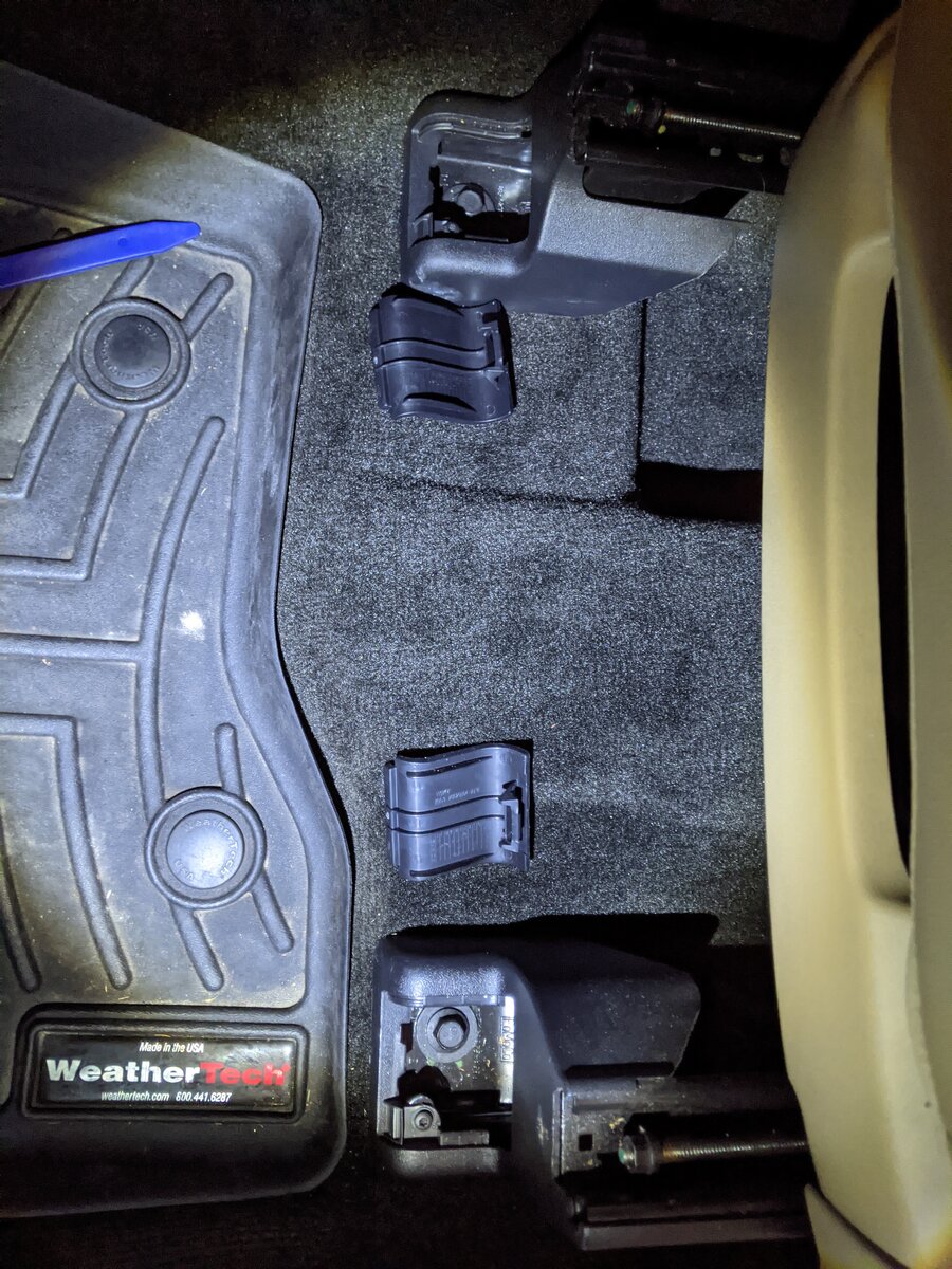

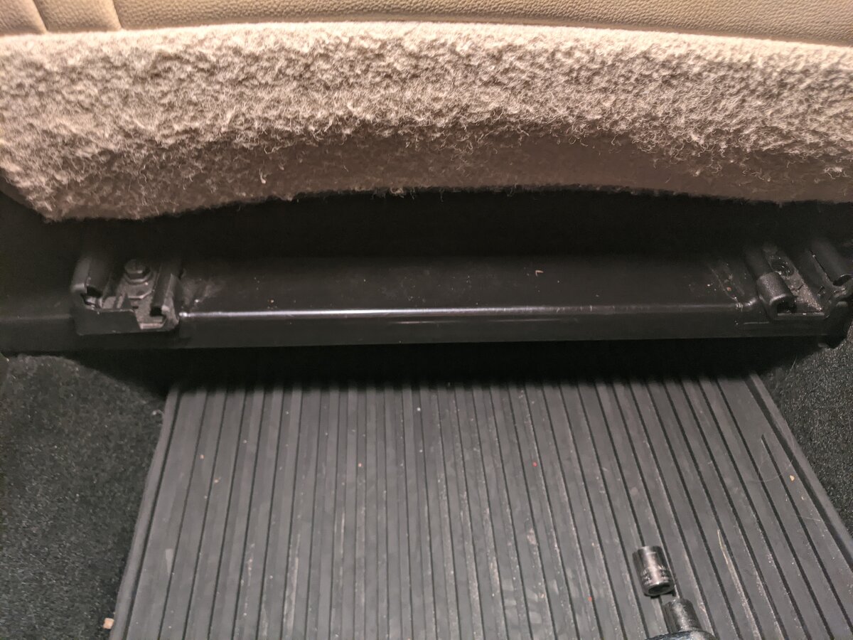

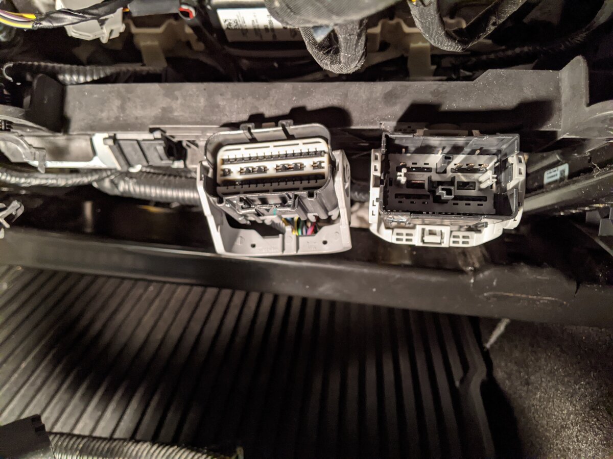

In case anyone needed pics, I added several; file names are in sequential order for seat removal. I just removed the driver seat in my '16 Explorer Limited in attempt to t/s the seat bottom cushion heater not working. To no avail, but I definitely got the seat out with little to no problem. I made sure to move power seat so that I could get my ratchet on rear bracket bolts, and that put seat a little over the two front bolts. But, ratchet still fit. Two 13mm hex bolts in front and same for hex bolts in rear brackets. Total of 4 bolts, the two large connectors that disconnect from driver's feet area, and there's a cable clip holding that harness to the seat. Then, you can remove the seat completely from the car.

Looking for a little more guidance and how to disconnect the wires. The connector seems to be similar to the one used on the airbag module which I had no problem removing. Feels like I’m going to snap this when I tried to move The arm back. Anybody have any tips? Thank you in advance for any help
