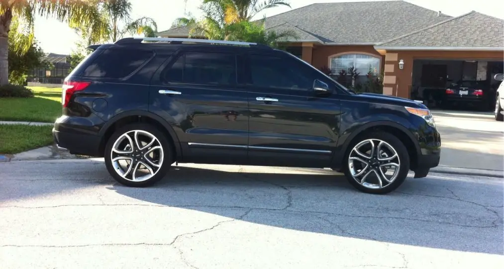

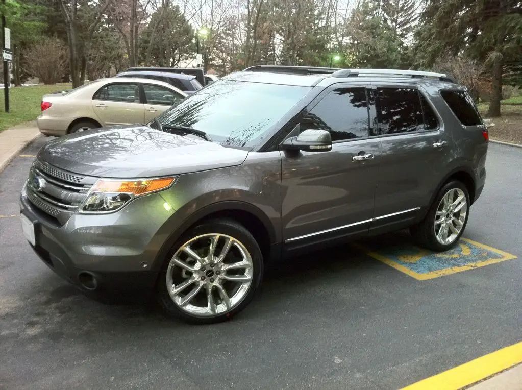

I have both wheels, fit no problem.
Mine
