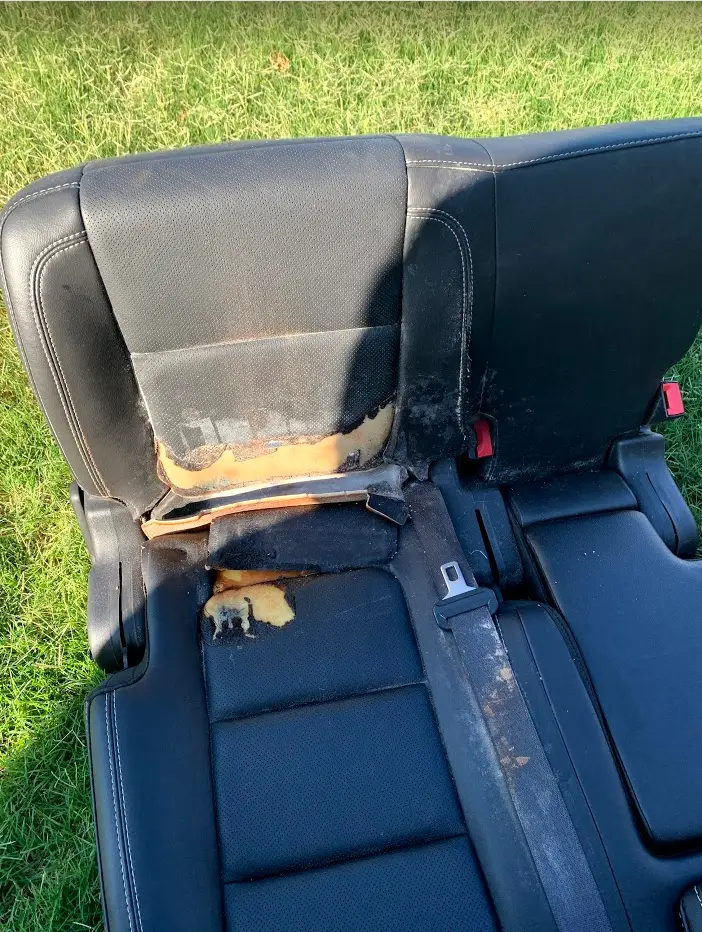

I'll attach a pic of the seat so you can see what a little bit of battery acid can do to your seat. The damage got worse over time as the acid kept eating away at the seat and foam.
