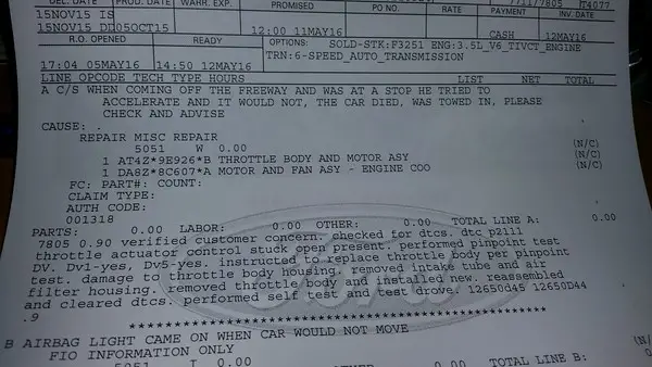

So the TB has arrived on 5/11!!! - installed, test driven, will be test driven today and if no issues, I should get my EX back tomorrow - plenty of time before the road trip!
TB replaced
Cooling fans replaced
Seat cooling checked and "OK"
So surprising phone call yesterday - he TB has arrived on 5/11!!! - Replacement TB unit installed, test driven, will be test driven today and if no issues, I should get my EX back tomorrow - plenty of time before the road trip!
TB replaced
Not that it will benefit me (up here in Canada), but credit is due for this excellent service you received from your dealership.
Throttle Body replaced, PN AT4Z*9E926*B THROTTLE BODY AND MOTOR ASY
