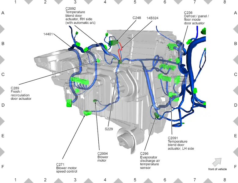

Hi,
My daughter has a 2016 Explorer limited and her ac isn't working in the afternoon. We are in Texas so the afternoons are in the low 100's. I have replaced the compressor, condenser, expansion valves in the ac system. In the morning, the output is around 40. In the afternoon it won't get below 60. I had her switch between hot and cold in the air was coming out in the middle. Then had her put the air coming out on the floor. switch between hot and cold. Then had her go to defrost, switch from hot and cold. It never came off of cold. Got up to 118. I had her take it off recirculation and the temp went down to 60. So I am thinking the recirculation is not working, thus cooling to 40 in the morning but only to 60 in the afternoon. Is there an actuator for the recirculating? If so, where is it? Thanks...
