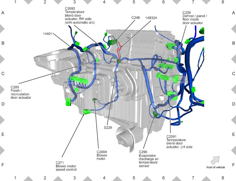

Just recently purchased a '15 XLT. We have had it about two months and it has 46K miles. The weather has been hot so we have been using the AC on dash or mid vent. This weekend it was cool and foggy so I went to use the defrost mode. I've found that it does not change modes, It stays on dash. It will not go to floor mode either. The hot/cold blend works fine and the driver/passenger temps adjust properly. The recirculation actuator is working fine. I was thinking it must be a bad mode actuator. I can not find anything on a mode actuator. I see they have problems with the blend actuator. Where is the mode actuator located? I pulled the glove box and can see the blend and the recirculation actuators. It doesn't work from the SYNC system or the buttons below. They beep and light up like they are working. It also comes off of recirculation when you switch it to defrost or floor like it should, but it stays blowing from the dash vents. When I do a search, all i find is mode problems on 2010 and older. Any help would be appreciated.

Not sure if this diagram is of any help. I believe it is for the 2013 Explorer.

Chances are it is the c236 door which controls the direction.

yh-1769 is what the dealership gave me for a part number on my 2016 with manual controls and no dual temp. looks like I have to look up to the right of the gas peddle. it is the upper actuator.

talked to a ford tech I know, the ipc (instrument cluster) has to come out as well. parts will be here tomorrow.
