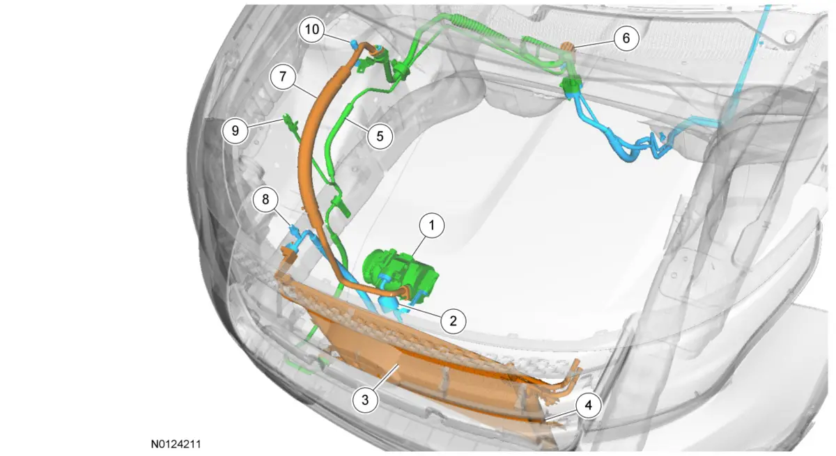

Oh boy, who has a picture of the engine bay to show where they are?
The AC lines have the pressure switches in them. Without a picture or diagram, the compressor is usually the place to trace the lines from. On each line if you follow it will be a small device with an electrical connector going to it, two wires. The lines go into the firewall of AC box outside of it, or the drier back there, the evaporator(or two) are inside the dash etc. The AC signal/trigger wire is going from the dash AC controls, through the firewall, to each pressure switch, and finally to the compressor relay which you have been working at. Somehow that signal isn't reaching the relay, or the AC control isn't producing the proper signal.

There's a switch I think on top of the condenser on the passenger side, the only"thing" with wires on it over there on the ac line. Is the low pressure switch integrated into the compressor? I will look later on in my knock off service manual for you.
The LPS is usually near to the drier, on the line going to the compressor. The HPS is often close to the compressor, on the other line, to the condenser.

There's only one pressure transducer on these systems. Its where I said it was before, on the top of the condenser, passenger side, number 8 in the picture below.
Okay. Thanks. I tried to bypass or activate that, but I didn't get anywhere. Now that I know for sure that it's a pressure switch, I'll try again.
It has three wires. No idea what they do or what the voltages are supposed to be. Maybe I can find an explanation online.
Check with an ohmmeter from the AC clutch power wire to those wires, one should read zero when the switch is "open." Tracing that circuit back to the dash AC control should find the fault or break in the circuit.
I'm confused, how have you ruled out that the pressure transducer switch isn't the bad item here? I don't understand how you've arrived at a wire fault as the definitive problem. Not being condescending, I just don't follow and want to understand. I'd go buy a pressure transducer and swap it in (you can do this without evacuating the system) and see if it works ($25 online). If it doesn't, send it back for a refund.
