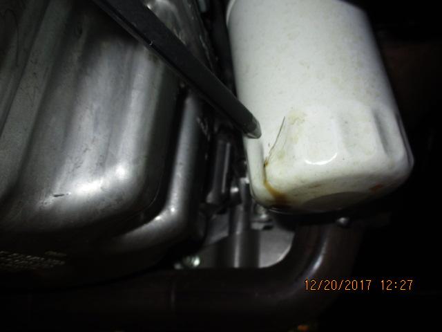

I can see how they can say the fixed the leak, I'm sure they replaced the oil filter and put new oil into the engine, its what's known as an oil and filter change. But I'm really struggling with how they or anyone can tell you that the engine is perfectly fine after running on less than a quart of oil? I have no idea how long or hard you ran the engine low on oil, but if it was for 500 or a thousand miles, probably not good for the long term life of the engine.

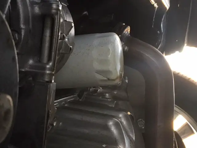

I also struggle with the slit in the oil filter. It sure seems like there would have been some sign of collateral damage elsewhere if something would have hit it and caused the slit while driving.

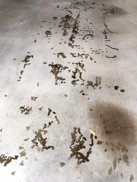

Just found this post via google. We have a 2017 that is now leaking after our first dealer oil change. It has about 23k on it. Never leaked until after the oil change. Took it back about 1 month ago for this issue and it is doing it again. I called for to ask what they did to fix it last time and they said nothing was documented. They do show it was in their shop.? We have an appt in three days lets see what they say this time. I ran the vehicle for 5 mins and this was on the ground see pics.

Are you sure it isn't a leak from the filter seal? I don't see why the oil pan would begin to leak after an oil and filter change. Keep us posted please.

That was my thought as well. The oil pan looks dry. Maybe the filter gasket isnt sealing or the old gasket was stuck to the engine(now you have 2 gaskets).
Take the filter off and inspect the threads, mating area for any damage or abnormalities. Also check the filter to see if anything is wrong. I have had motorcraft filters do that to me before. I have switched to a (IMO) better filter, either Mobil 1 or Napa Platinum, both are synthetic filters for extended oil changes. I would try this as something cheap and quick before running it back and forth to the dealer. Good luck.
