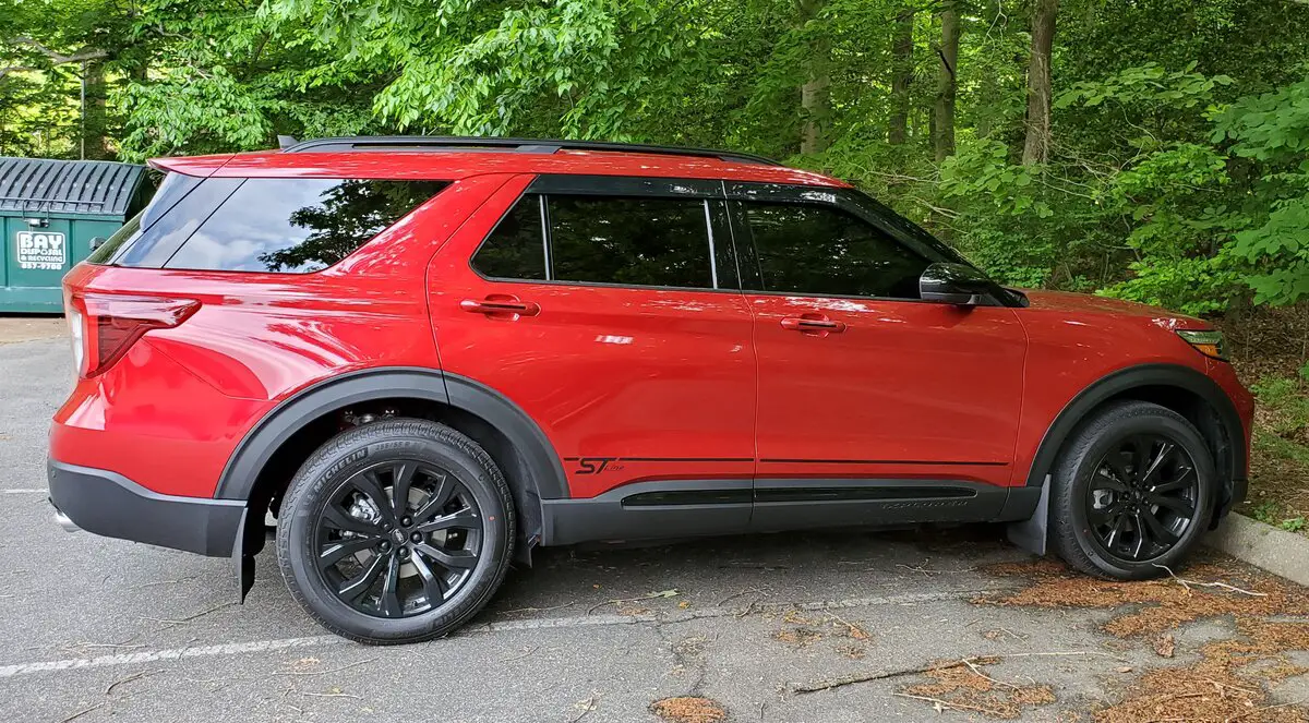

Others have used Plasti-dip. It's a spray on application. Many YouTube videos on how to do it. Or spend some big bucks and get new wheels and buy a grille from Ford. Also, there are a few wheel dealers who will sell you powder coated OEM wheels. I got some from a supplier to swap out my ST-Line 20" wheels for the ones in the picture. Let me know if you want info.

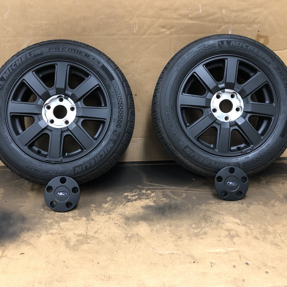

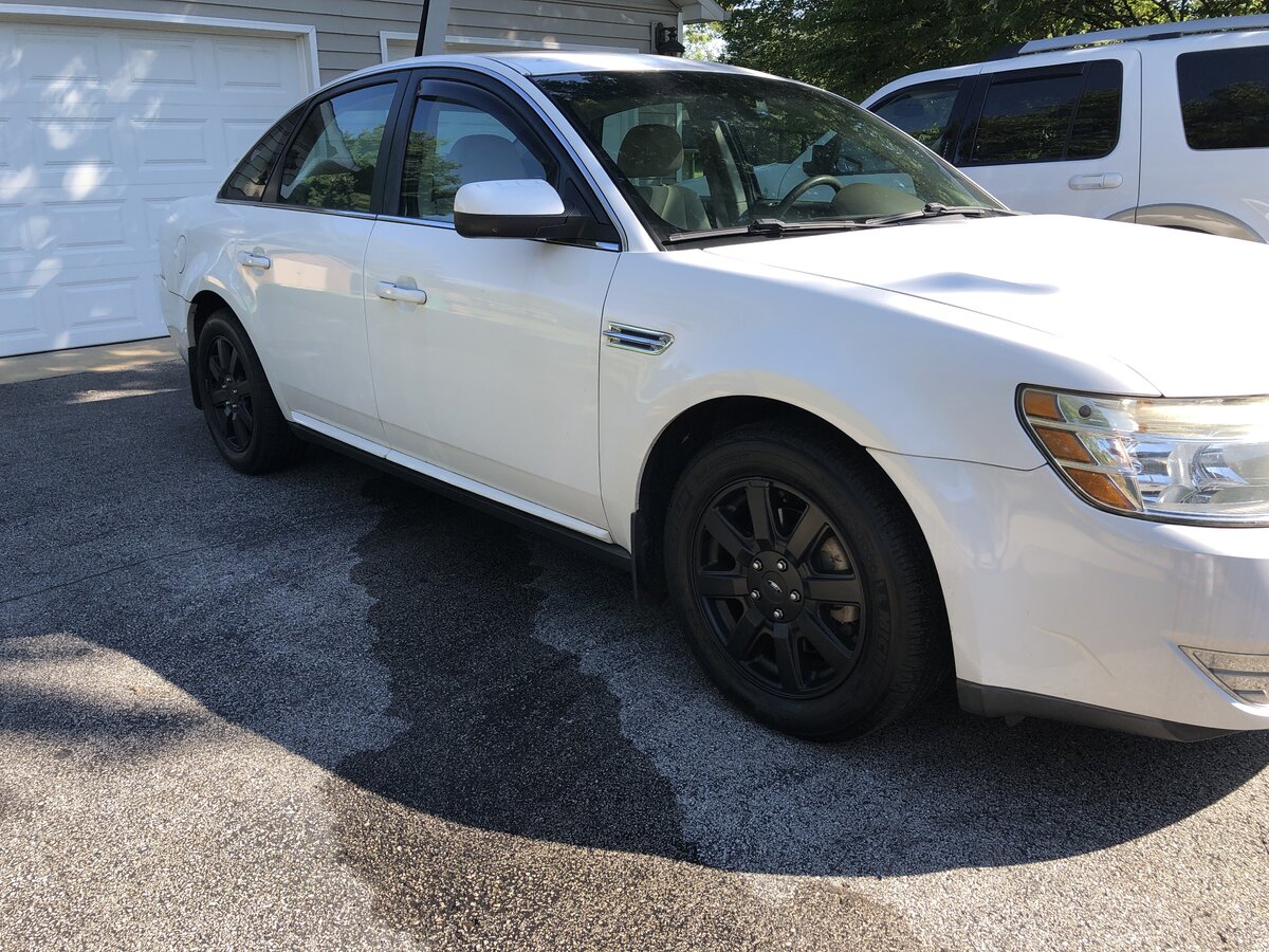

I have an 08 Taurus that I bought from my parents for the kids and the clear coat on the wheels was in really bad shape. It was discolored and flaking off and I thought hey - it can't look any worse. So I pulled them and knocked off the flakes and smoothed down the lines and plasti-dipped them. That was about 2 years ago. Some observations:
  • Use the glossifier - I didn't and they are hard to keep clean.
  • I don't usually use wheel cleaner but with the consistency of the plasti-dip you pretty much have to. It will make them look splotchy but I've found that Meguire's car wax shines them right back up and evens out the color.
  • It's the easiest 'painting' I've ever done. It leaves a slightly rough texture but it's really easy to lay down and build up.
  • I haven't tried to peel it off yet - haven't needed to - time will tell.
  • I don't regret doing it for a minute - but they weren't pristine rims to begin with.

Good info. Thank youi
