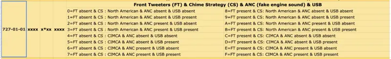

I can confirm the f150 method does shut off the engine noise. I just did it and took it for a drive.
First line in ACM, 6th digit is a 4 and needs to be changed to a 0 (zero).
Are we sure of that not disabling anything else? See the attachment below. Looks like that kills the tweeters and USB if it truly is the same as the F-150.
(The screenshot is straight out of here)
Tweeters and center speaker are functioning.
I'm honestly not sure which USB device they are referring to, but does your USB interface to the audio system seem to work? Just want to clarify before going out and doing the same thing.
The USB port in the center cubby still has power and charges my phone when plugged in.
9 would be the better choice than 0

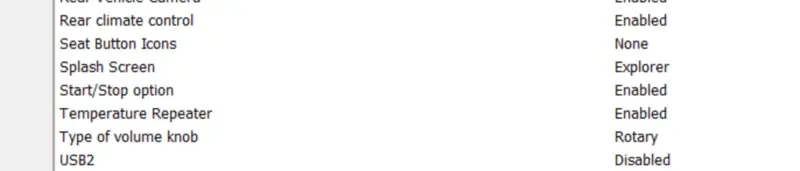

Another edit: Start/Stop is listed as an option now in the APIM. I'm not sure if this flag will fully disable it or not, and I'm really new to the FORScan game, so I don't want to brick my stuff and have a problem. If there's someone braver out there, update to the latest release, and it will be in the basic APIM module screen to play with.
I mentioned this in post 3. I saw the enabled and changed it to disabled but it still reverts back. In order to fix it permanently, we need the line code and change the coding like you did the double letter horn honk.

I did go to the drop down menu and changed it to disable and it did work. I am curious if it will revert back.
Going back on my memory, the drop down for the start/stop showed it as disabled and when disabled, the A with the cross through it shows up on the dash (I did it again tonight) but even with it showing on the dash as disabled, it still did the start/stop.
Maybe this newest version fixed it.. I disabled it again and did 3 full restarts and it shows disabled on the dash. Wont know till tomorrow if it actually still shuts off or not.

I went ahead and tripped the Start/Stop and will see tomorrow if it persists as well. This is at:
7D0-01-02 / XX0X XXXX XXYY / Disable Start Stop (Maybe?)
7D0-01-02 / XX2X XXXX XXYY / Stock Start Stop Setting for my Explorer
My As built is
7D0-01-02 026B 0C04 8AE1
which doesn't align with the third location being consistent with yours? are you sure of the location on this one?
