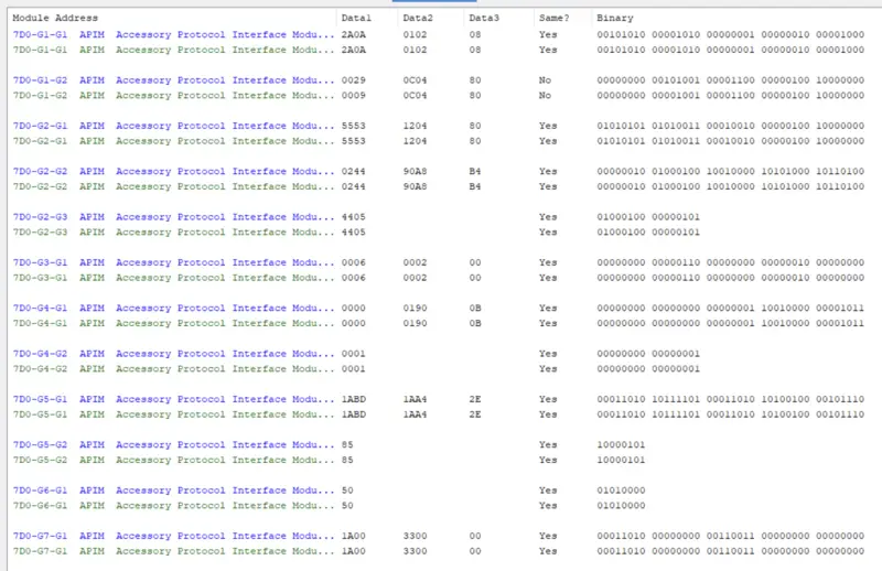

100% sure. What I did was take a snapshot of the as-built. Then I changed the option in the basic configuration screen. Then I went back and took another snapshot of the as-built. That was the only flag modified. Whether there are more variables is primarily why I think it needs more evaluation. But I can guarantee it was the only change, and it went from a 2 to a 0 on my vehicle. (The rest of mine is 0029 0C04 80YY).
Ignore the addresses on the left; not sure why the program does that. But here is the comparison, and the only modification was changing that variable.
I have NOT confirmed that it works yet. blwnsmoke seems to think it stuck, but I won't be able to validate until tomorrow.
EDIT: If you wan't to confirm, you can do the same procedure where you save the as-built data, change it in the basic menu, then save the changed as-built data and see what changed. It can be put back right away if you don't want to leave it with it being unknown right now...
ok, was just strange that my as built had a 6 in that location. I will have to try and set the mode and see if that location is what changes in mine. Thanks for digging into this.
I'm a little weary of what that changes. That's why I waited until someone else tried it first. Since blwnsmoke seemed to have success, I figured I'd give it a shot.

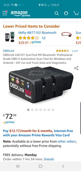

Forscan software (free), windows pc/tablet and this.
I snatched it during a lightning deal during Prime Day for $44.99. Best one out there to do programming changes.
I saw there is an MX+ now that is $99 or the one listed about. Which one should I get? I had a usb one for the 2016 but it was a pain.

The one I posted is sufficient for making changes. IMO no need to spend more.
