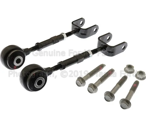

Have concerns about the new toe link design. This is the current model that was installed on my 2015 explorer with only 27,000 miles.

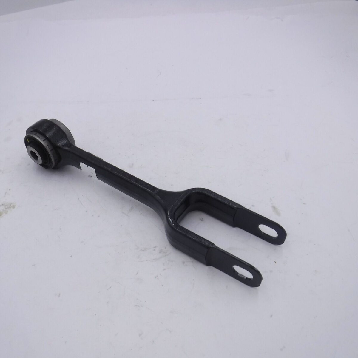

This is the new model that ford wants to install.
Note the lack of the toe threaded adjustment link. On the new link, toe in adjustment is performed by sliding the new link between the nut and bolt in the knuckle as the link has an elongated slot, not a hole. So the new link does not allow the mechanic adjusting the toe to have the precision or ease of adjustment as the old link did. here is a video of a Ford mechanic struggling to adjust the toe.

Personally, I feel this is a piece of crap way to adjust and hold toe. It should be a threaded rod that is “locked” in with a locknut, the way the old link was. My opinion is since the link is elongated the first big pothole you hit is going to move the link and change the alignment. The new link is only pinched by the knuckle bolt, not locked into a round hole like the old link. The old link did not have this elongated hole and the only way the alignment could change is if someone adjusted the threaded rod.
Ford eventually figured out the toe links were breaking because the toe link ball joint was seizing in the knuckle putting undue strain on the toe link. The new unthreaded rod is overkill because they simply did not know why they were breaking in the beginning.

You hit the nail on the head! as a Ford technician (34 years) I can tell you I don't like the new design and none of the technicians that I work with are impressed either. I don't see how the new design can hold position that well, I've done a bunch with no issues though. They are a pain to adjust and to top that off Ford cut the labor with the new design we get paid one hour to install the links and adjust the rear toe.

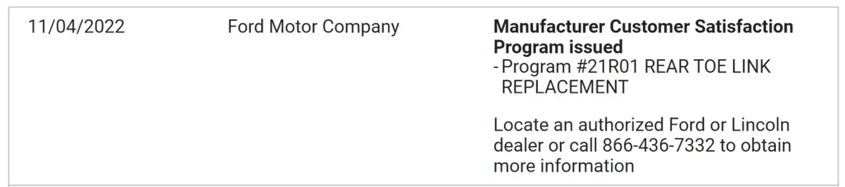

Interesting... Mine had been done as a "Customer Satisfaction Program" (21R01) at the ford dealer mere days before it went up for sale. Ill have to keep an eye on it.
Pretty sure the PIUs didnt have quite the same problem though. It appears my replacement link is much beefier.
I believe I miss understood...
Guess Ill have to take it in sometime

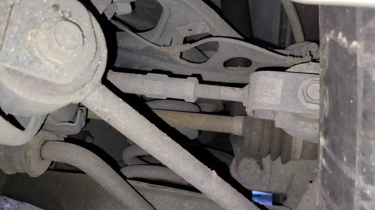

I specifically asked the SA to ask the tech what the break-loose torque was. He reported it was 108 lb-ft. I don't know if he just threw that out there to shut me up or if that was a real measurement. Personally, didn't trust that report but I resisted the temptation to measure it myself beforehand less the dealership see the bolt and nut had been touched and turn me away.
Actually 111ft.lb for the outboard bolt per the recall.
