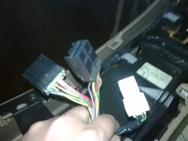

For those of you who have the consoles with the computer system
When you remove the computer panel (which is what you will remove first)
there will be three plugs in the back of it, they simply unclip. Thats the only difference between the computer console and the one without the computer.
