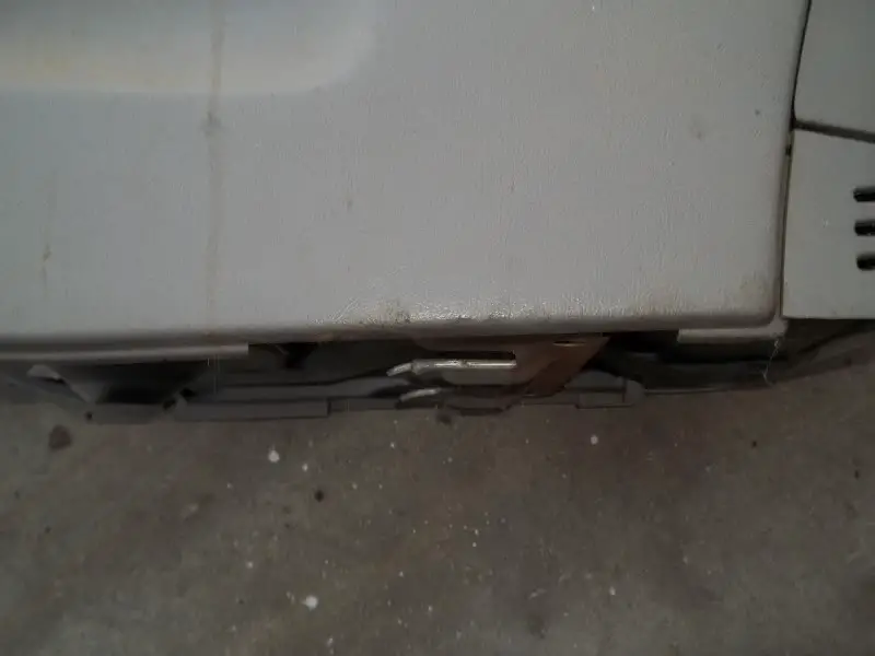

Old thread but just incase anyone reads it through to the end this might help. So I wacked at my console for 10mins (all bolts were removed) and it didn't move. All I did was bend the bracket. I looked under the rear of the console where the clips grab the brackets. I jammed a flat head between the clip and rear of the bracket and pried on it and the clips easily slid off of the bracket. Maybe my 6lbs loosened it?
I am also having a hard time removing the console, even with pounding on the bracket with a big hammer. I am having a hard time telling by the picture here, but how far back are the tabs? Is this view from the side? And would I have to remove the seats to get to the tabs, or can I reach them with the seats still in place?
Yup,there is a description and instructions about these clips right above the last picture in the first post
