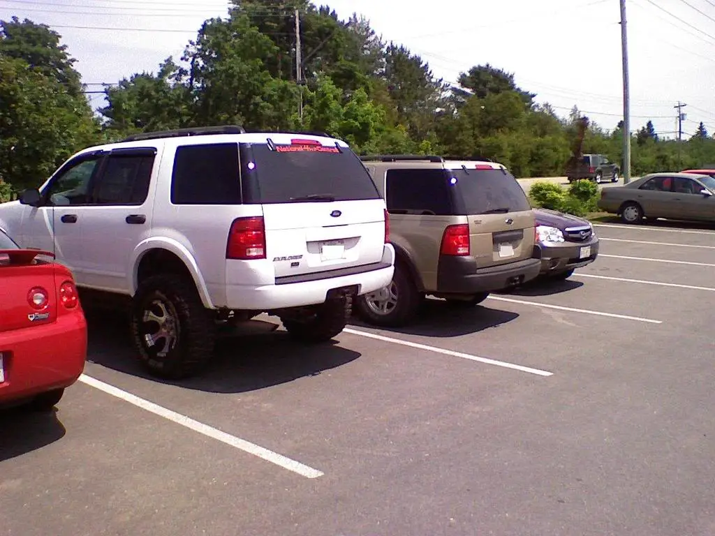

Black, of course... I'm at a loss.
ThanksIs this the sites significantly lifted 3rd gen? Very nice!!
i envy you what exacly would it take to do this to my 04
after seeing all this i think i've decided on doing the 3 inch body lift..
i just have a few questions..
1) i saw where you said you had to trim the fan shroud, but yesterday i was looking at mine and it appears you can remove the lower half of the shroud by itself...would it lead to any problems if i just removed it?
2) were any special tools required
and 3) think it'd look good for a mounty?
only thing for me would be I'd have to just remove my hitch as i don't have access to machining tools
1) yes, the bottom of the shroud does come off, I actually took mine off to trim it, but it does function to direct air through the radiator, so I would trim as little as possible, I'm no mechanic, but that's just my opinion.
yeah i was thinking about just removing the lower half all together but thats probably not a very good idea i guess
and what would you reccomend i do about my rear bumper situation?
i don't have a way to machine the brackets but i also dont wanna cut into the plastic bumper either
