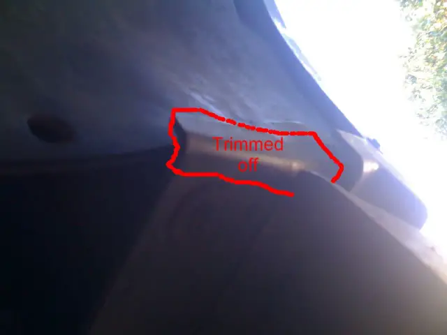

33"s on my mounty with just a 3" body lift.
you'll have to trim back a little behind the front wheels and ziptie the inner wheel well back ..not really too major..
ik that sounds confusing though its hard to describe
once that was trimmed off (all it was was fiberglass that stuck out from where the front quarter panels mount to the bottom of the body..didnt structurally hurt anything not to mention it was east to trim bc it was just fiberglass) i just ziptied the wheel well back and all was good
all i have is a slight rub on the passenger tire on a full lock right turn..been over somewhat bumpy terrain and hopped a few curbs with the wheel turned and no rub (unless full lock right turn like i said before)
to me it was def worth the 1/4 - 1/2" i shaved though

doubt yours are gonna fit just due to their width ..we're ( 3rd gens with 33"s) are running 285/75's which are 33 inches high but only 11.5 inches wide ( if i recall correctly) and i honestly cant see another inch of width fitting but i also fall in the only 3" lift club
12.5 with stock rims no way imo, but however pick up some 1.5 wheel spacers on ebay for 120 bucks or get new rims;)
