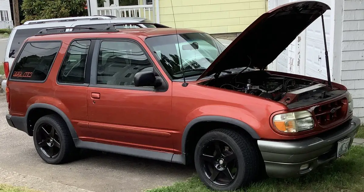

Good day,
I have the need for speed but unfortunately I don’t know how fast I am going. I have a 302 swapped 2 door sport with no working Speedo I was wondering if anyone can help me. It’s a
97 body
00 5.0 engine and ecu
04 mustang transmission 4r70
8:8 rear
i did the swap 5 years ago, I remember I had to pin out the tach in order to get it to read correctly
but I don’t remember having to do it for the Speedo.
it has the sensor in the rear. I swapped it out with a new one but had no effect.
im new to the forums and was not sure were to post this but since the truck was built with the idea of speed implied I figure I would come here.
thank you.
