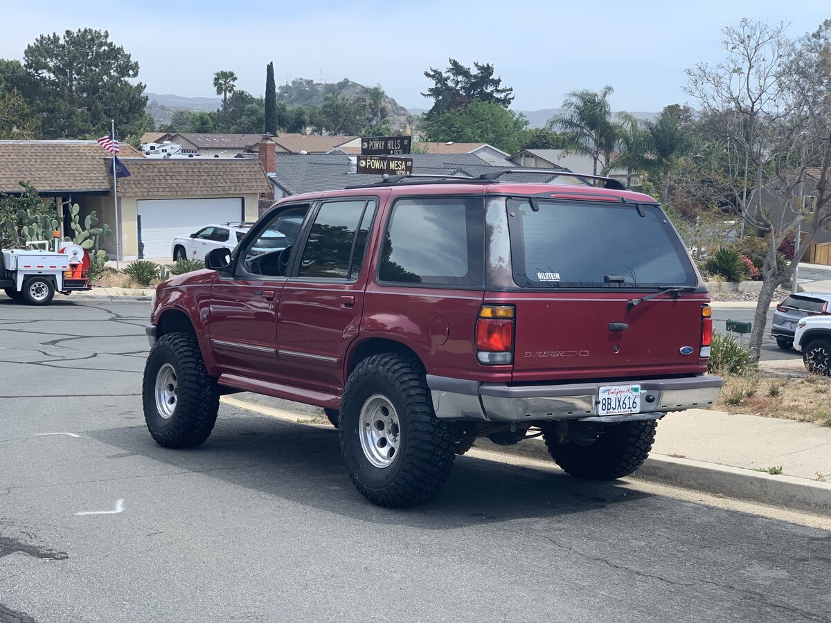

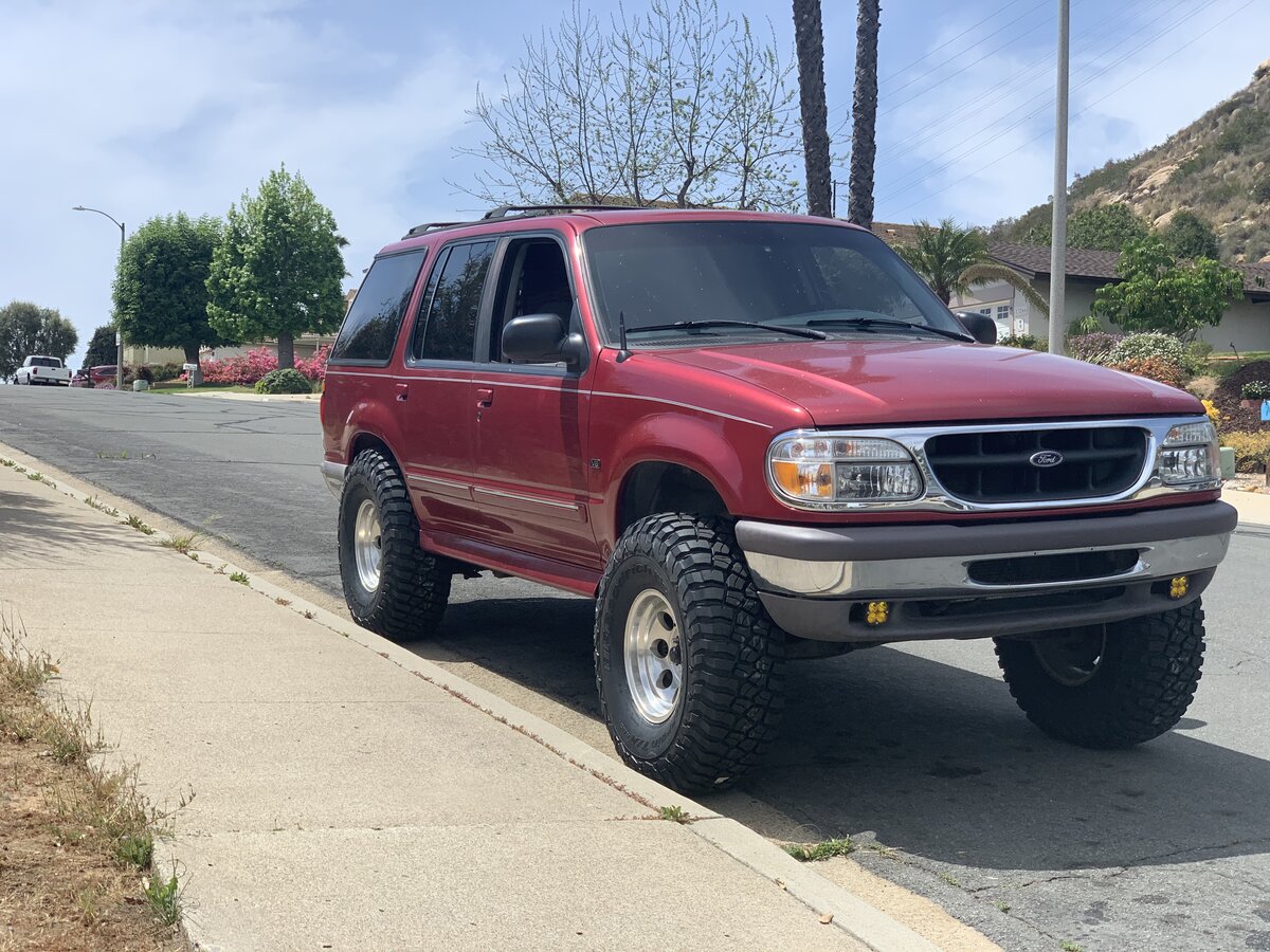

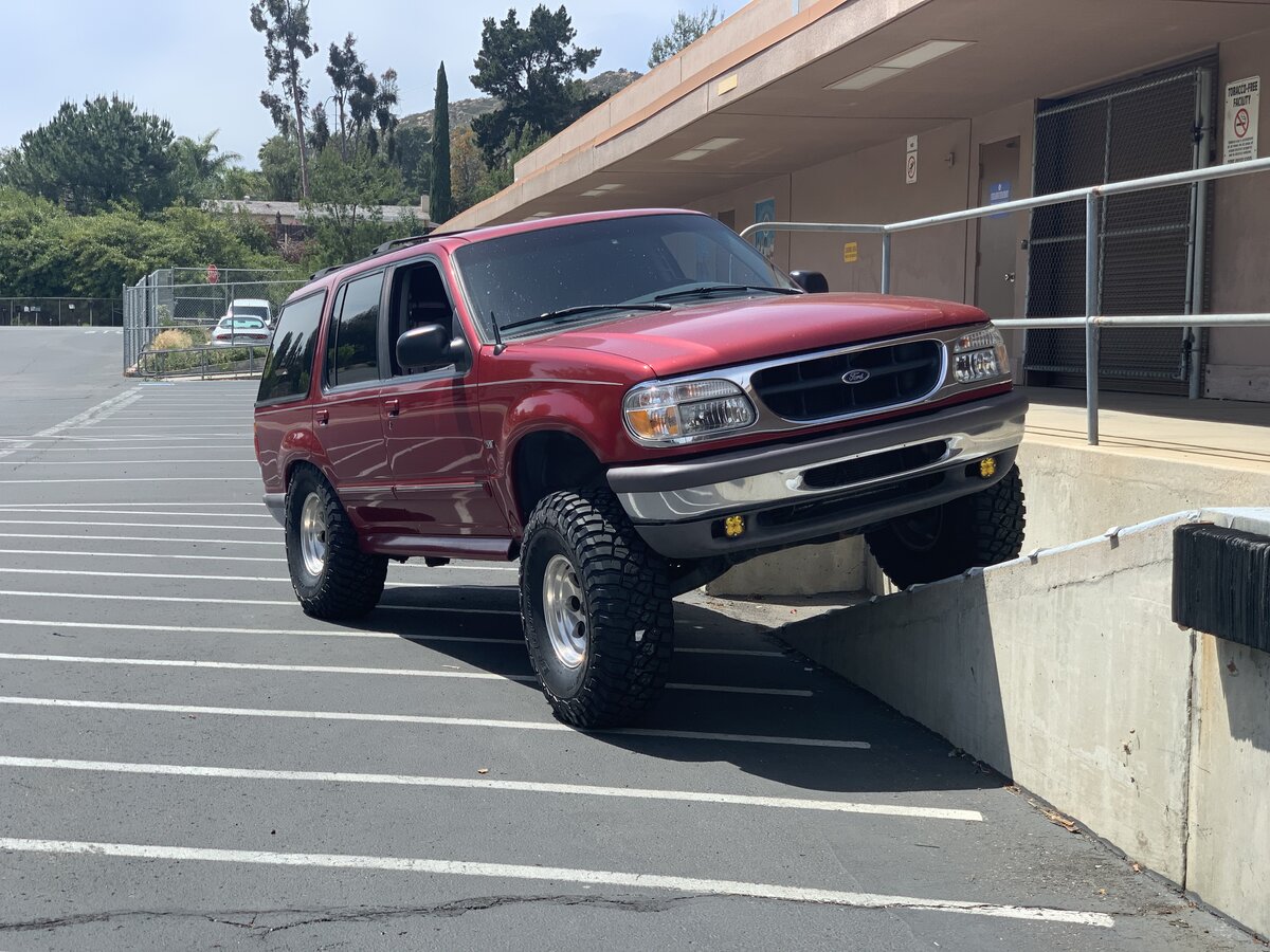

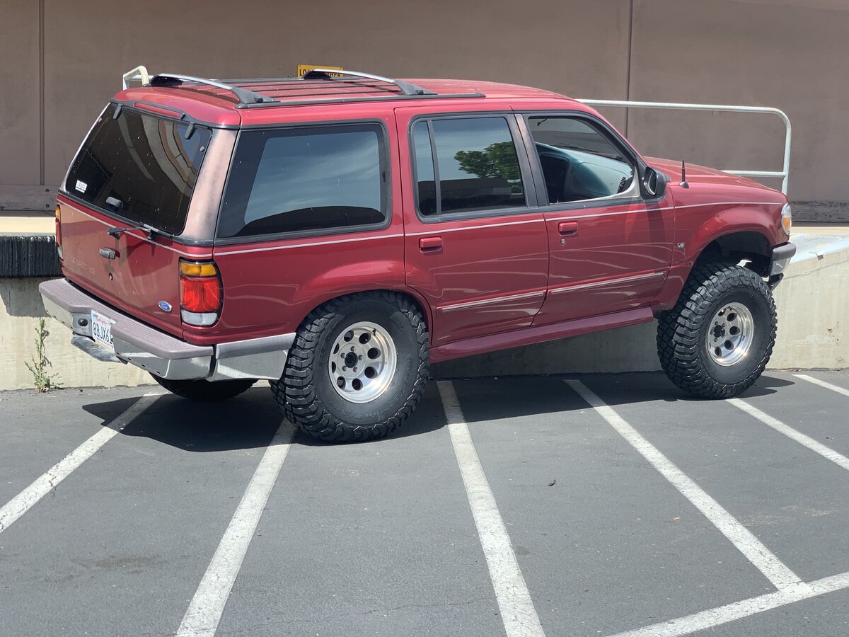

4” spindle, stock sagged out rear. 35x12.50x15’s 8” wide wheels.
Either 4.88’s or 5.13’s when I finally choose a locker! It has 4.10’s now but I’d like 2nd to be more useable in the sand.

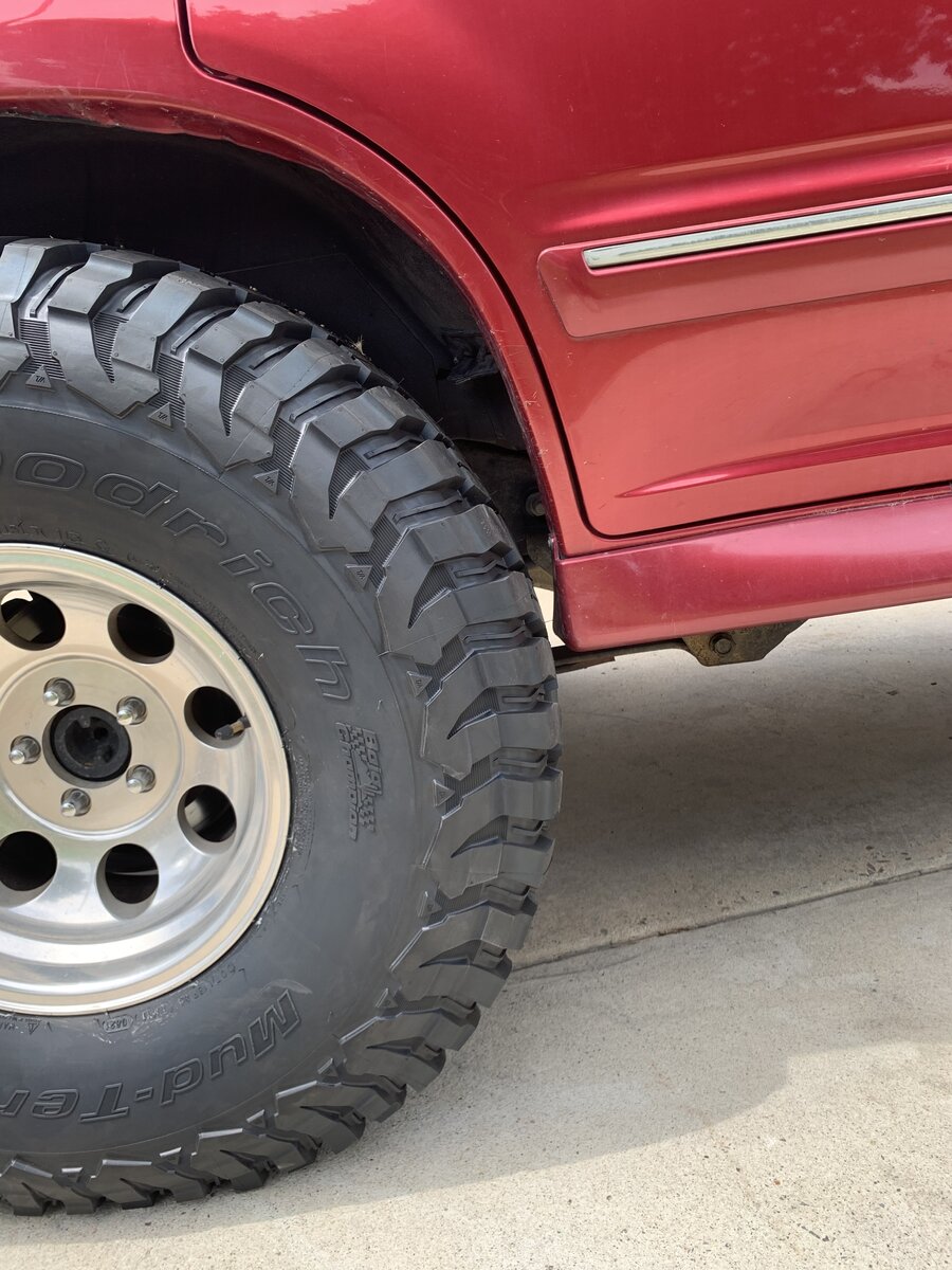

Also, just to throw this out there... if anyone plans on putting 35’s on an explorer this low, be ready to ditch the lower door trim and the front bumper lower valence. It’s rub city!
