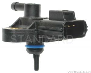

There is a fuel pressure sensor on the fuel rail that is monitored by the PCM. The fuel pump is pulse modulated to maintain a constant fuel pressure to reduce emissions. As I recall 45 psi is about right. There is a fuel pressure regulator in the fuel tank to limit the pressure to around 65 psi.

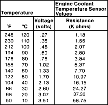

ECT sensor test
The easiest way to test the engine coolant temperature (ECT) sensor is with an OBD-II scanner (or equivalent) reading the ECT value reported by the PCM. The other method is to refer to the following table.

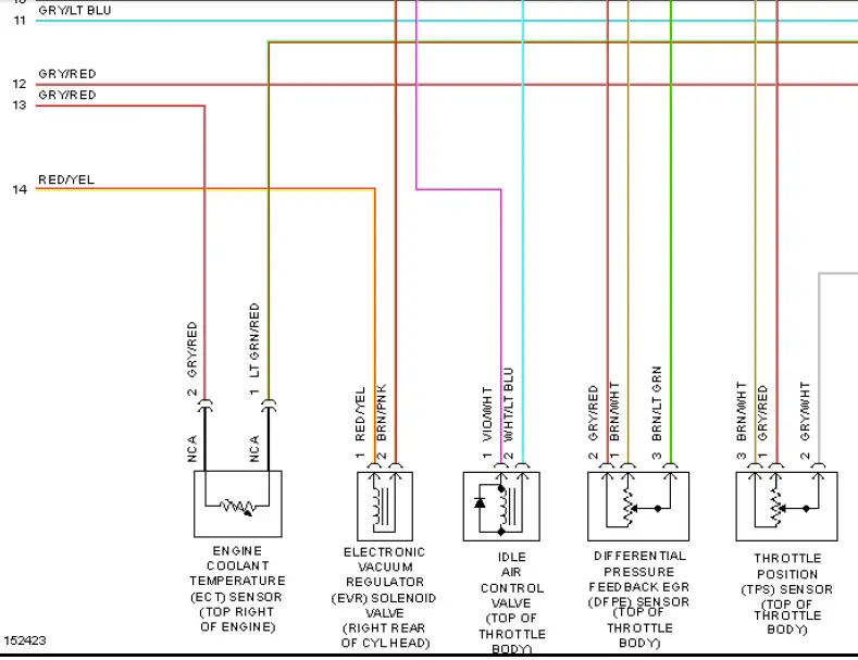

You can measure the resistance between the GRY/RED and the LT GRN/RED wires at the sensor connector.
A better test is to measure the resistance at the PCM connector since that also checks the wiring to and from the sensor:
PCM C175C Pin 46 ECT Input (LT GRN/RED)
PCM C175C Pin 17 Sensor Return (GRY/RED)

Another possibility is fuel getting sucked into the intake manifold. There is a fuel pressure sensor on the fuel rail that has a vacuum hose attached.
I suggest disconnecting the hose and checking for fuel in it. There might be fuel flowing thru the pressure sensor to the vacuum hose. If there is no fuel in the hose plug it and then switch the ignition to run to see if fuel squirts out of the sensor vacuum port.
