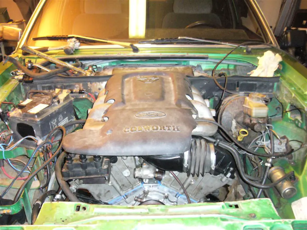

I am at work at the moment so I don't got access to any pictures....

Got the engine in another car now. Upgraded the gearbox from a T9 to Mt 75, sinter paddle and sachs racing pressure plate for escort cosworth, should cope with almost 800Nm of torque. I have also modifed my injectors so they flow close to 600cc/min. I have replaced the sprocket that drives the "4,0" camshaft for a bigger one due to excessive wear. Had some turbo plans, but they have to wait, otherwise I won't get the car out to the summer.... I have also invested some money in better tuning equippment. Plan to get the car ready within the next 2 months....
