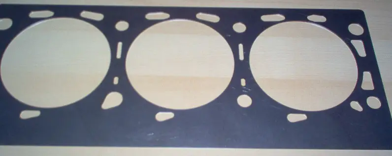

Buying the car for the engine on saturday if everything goes as planned, it only weights 1210kg, so 0-60mph should be wrooooom. The head gaskets have been cut, still waiting for the copper for the firerings. Did never buy that SOCH, I got enough to do anyway. Got a slide inlet under construction, I have also bought a set of bigger injectors. Getting the pipes for the headers and exhaust next week. 42mm inside diameter, 60cm long, baffle collector, 2.5" from collector to where the sides meet up and then a 3" single pipe to the rear. Still need to find 6 air filters of correct size. Also thought of buying other springs and shockers for the car and also poly bushes all around. But maybe I should wait with this until I got the car rolling with the engine. I'll make some updates when I got some new pictures....

The headgasket assembly.
The copper fire-rings are still missing

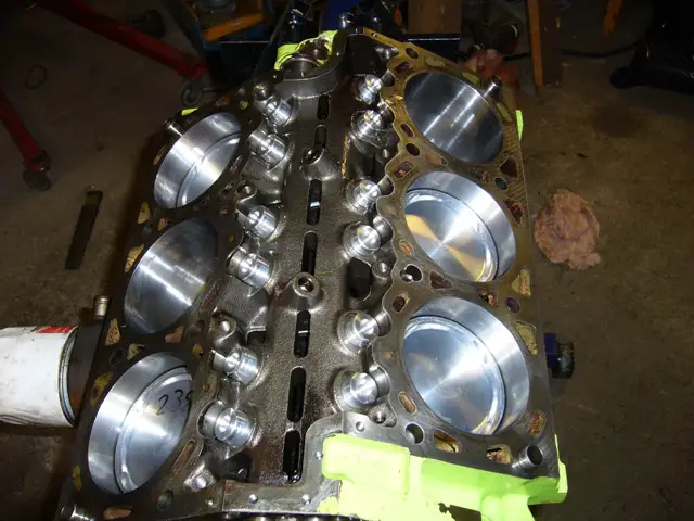

Getting closer every day now:D
The rods are Procomp 6" for chevy SB, modified to accept ford crank and rod bearing and also a 24.005mm wrist pin (not stock pin).
The wrist pin is custom made out of 4340 steel, 61-62 HRC hard.... (try to kill it with a hammer and you'll see which of them will break first;) )
The piston is of own design, cr 10:1
Cory, I won't be reving much more then 6000rpm so Don't worry about the weight, the engine will be boosted in the future so the bottom end is be built for that. There is enought material in the piston heads to decrease the CR.... By the way, was Dave able to help you?
Are those lifters in the top pic, or just dummies installed for the purpose of filling the holes? I thought this was a DOHC project...:p:
