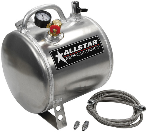

When I rebuilt the engine in my ranger, I used a tank pressurized by an air compressor that the engine oil was in. I used a hose connected where the oil pressure switch goes. I had 60 psi oil pressure on initial startup.
I'm trying to picture this. Maybe look for a YT to give an idea on this. My 5.4 cranked for a few times and got psi right away and was good to start in a short time.
That explains it and a visual of the item
Now understanding the concept, decided to go roundup some parts for the pressurized oil prime technique. It may be later this afternoon till we have any progress. It fights me every step of the way.....
You can build the tank from parts for less than that. I used an air tank from a semi truck I got at a junk yard

A 1.25 gal bug sprayer worked perfectly connected with the right fitting going into the oil sensor hole. When I pulled the sensor out to do the prime trick, no oil had even reached it all the cranking I did the other night. It took 1.5 qts of oil soon coming thru the rocker arms. I gave it the rest what I put in the tank about 2 qts. Earlier posted during tear down how facinating all the oil passages were to see; it's no doubt how much oil it would take to fill them all.

Much easier than a drill turning the oil pump trick. I'm just as anxious to hear this project come to completion.
