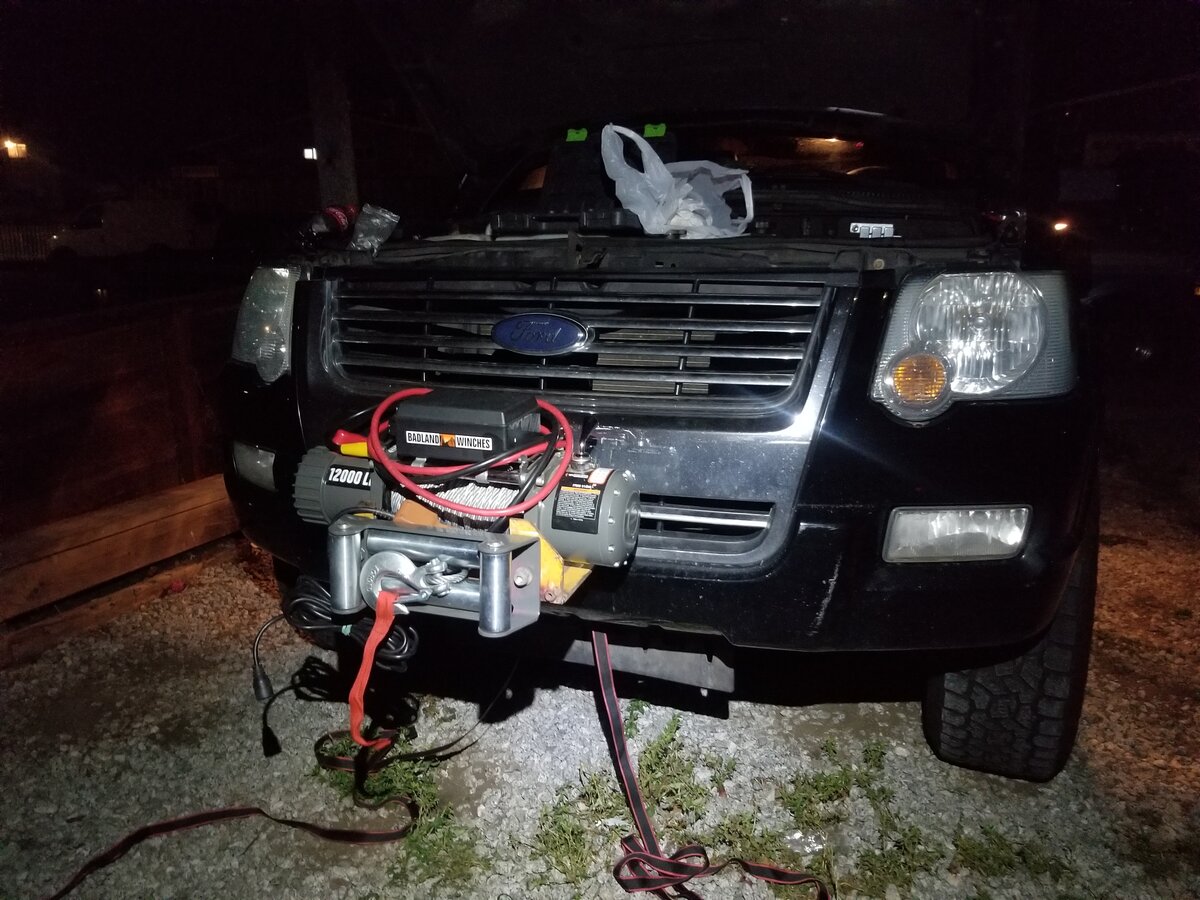

Ok, so I installed a front winch on my explorer recently, (see second picture) and since I had not really seen anyone describe how to do this besides custom fabricated bumpers, so I decided to show yall how I did it. Also for this you will have modify the plastic of the bumper. Here we go

STEP 1: Remove the front bumper. to do this you will need to remove a series of plastic clip like things on the top in front of the radiator, then you need to remove the headlights as well as two smaller bolts from the underside of the bumper.
STEP 2. You will need to take off the curved piece of metal that is the actual bumper.
STEP 3: Take the 18 inch piece of two inch receiver and cut one of the ends off. You need to cut the end off that the trailer hitch would attach to so that you have a long chunk of two inch square tube. make sure to cut tube behind the hole where the pin would go to secure the trailer hitch.
STEP 4:
Take the hitch step receiver mount and place it on top of the piece of square tube. Essentially they will be stacked on top of each other so that the square tube acts as a spacer to elevate the hitch step receiver mount.
STEP 5: mark where the bolt holes in the hitch step receiver mount line up with piece of square tube. Then drill on these marks all the way through the square tube. Pick a drill bit that is the same size as the bolt holes in the hitch step receiver.
STEP 6. Remove the curved metal piece that is attached to the front of the car. it is shown in first picture. Find the center of it and find the center of the piece of square tube. Line them up and then mark the curved metal piece through the holes you just made. Then drill through the holes all the way through both sides of the curved metal piece.
STEP 7. Now you will need to take some very large bolts and put the whole thing together. You will essentially have the piece of square tube sandwiched between curved metal piece and the hitch step receiver mount. The bolts you picked will go through all three pieces.
STEP 8. Now put the curved piece of metal back on the car. It will slide on and you can bolt it back in temporarily.
STEP 9. If you look at the top

Yeah not sure why it cut off at step 9. There is a little cutting in the grill required but not much needs to be cut. On my 06 limited I just needed to cut a small piece out of the single rip that goes across the lower grill (the little slot that is around 3 inches big and sits below the main grill. There is plastic cross piece going across this slot). The hitch receiver is just the right size to fit through this slot once the cross piece is removed, and the receiver is pretty much flush with the edge of the bumper. If people are interested I can do a video of it at some point or at least post a complete write up.

Been really busy with work but I finally have everything together(no reinforcement yet though, that's coming).
The way I did it was welding a 2" hitch receiver to a steel plate, then drilling holes in the plate and the top of the bumper and bolting them together. I had to do some cutting into the plastic bumper cover under the lower grille. I also made my own hitch mount for the winch by welding a solid 2 inch square piece to a steel plate, welding a small steel plate upright for the fair lead, then drilling holes for everything. Still figuring out some QD wiring because I dont want the 100+ lb assembly hanging on the flimsy bumper until I reinforce it.
