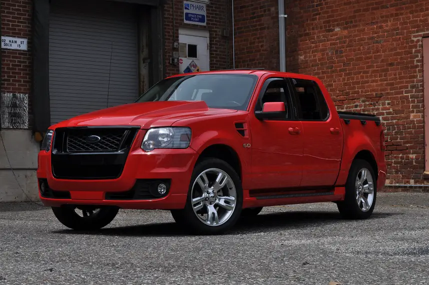

A few pics of the Coyote Adrenalin with the new hood and badges.
Sooooo fine!!!!
You really did a great job with this swap. Another one of those "Ford Should have done it" builds.
Congrats!!:chug:
Sweet! Any chance of taking it to the track to get some #'s?
Waiting on it to stop raining every evening here in the south. Shooting for Friday night if the weather holds off.
Sooooo fine!!!!
Congrats!!:chug:
Thanks Rick!
That is one bad ass ride you got there.
