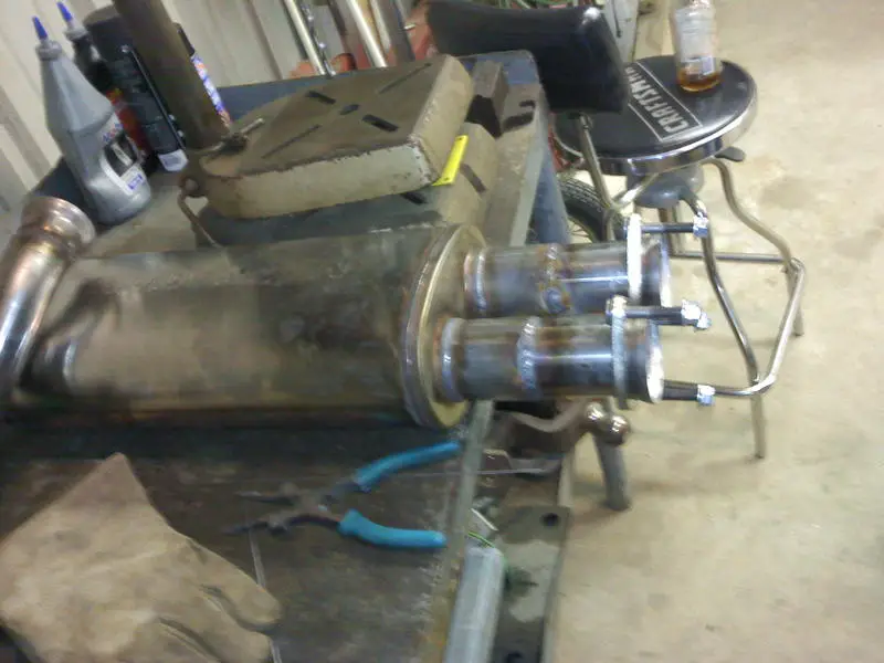

I am running full dual exhaust in my 2000 5.0 Xploder... I ran mine with no cats and a single X style dual in/dual out muffler. I went straight off the TMH's into the dual in dual out muffler and then straight out the back. The muffler acted as the crossover and fit perfectly under the car. I have no spare tire though. Currently it is 2.5" duals front to back... Going to change it to 2.5" off the headers into the dual in/dual out muffler and then 3" duals out the muffler and out back.
I used a FULL BOAR MUFFLER and the exhaust sounds awesome (IMO, lol).
Muffler:
Exhaust currently before it was tweaked a little (added bung to fit A/F gauge sensor)... Going to adjust this again by moving A/F sensor up closer to the headers (into second o2 sensor bung) and swapping to 3" pipes after the muffler can be seen in my build thread for some ideas HERE.
I have rear cats removed, dual in /dual out muffler and 2.5 tail pipes. Mustang cam and torque monster headers.

What I did

I have some good pics of my exhaust setup in my album not sure how to move them here:mad:
Those are great pictures, I love that the perspective is while on your back. That is very good for any stock or mild engine.:thumbsup:
