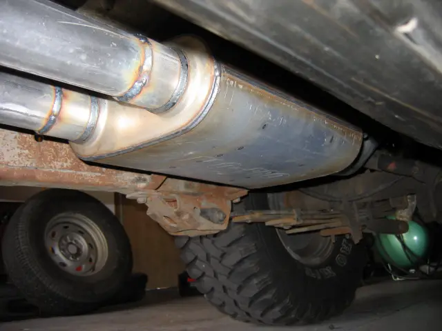

here's the best pic of the muffler I have on my BII:
Flo Pro dual 2.5" inlet, single 3" outlet:
Not sure of the dimensions but I could measure it

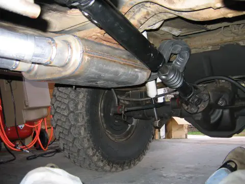

On the Explorer:
Again Flo Pro dual 2.5" Inlet, single 3" outlet muffler ( I told you my exhaust guys kick butt, look at those welds and the bends, better each time I go there, also the hangers they used for me are STOUT after breaking two they re-did the BII 100% using off round style mounts, no rubber do nuts on these rigs)
But this time 2.5" pipe out the back with a stainless tip:
