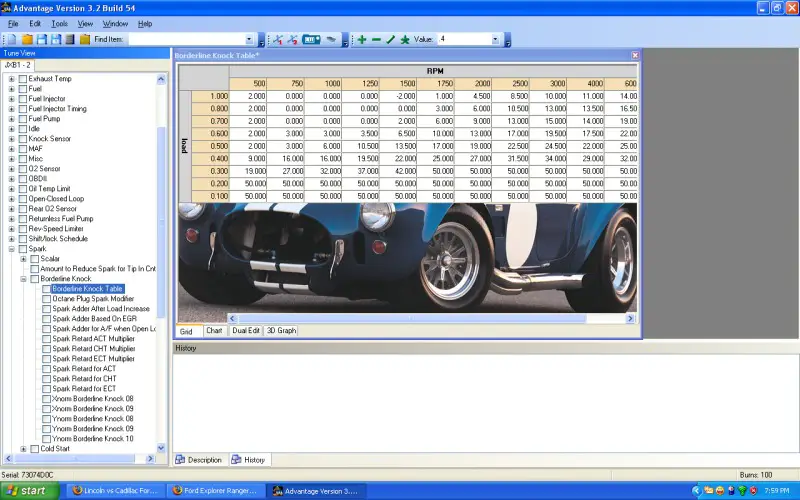

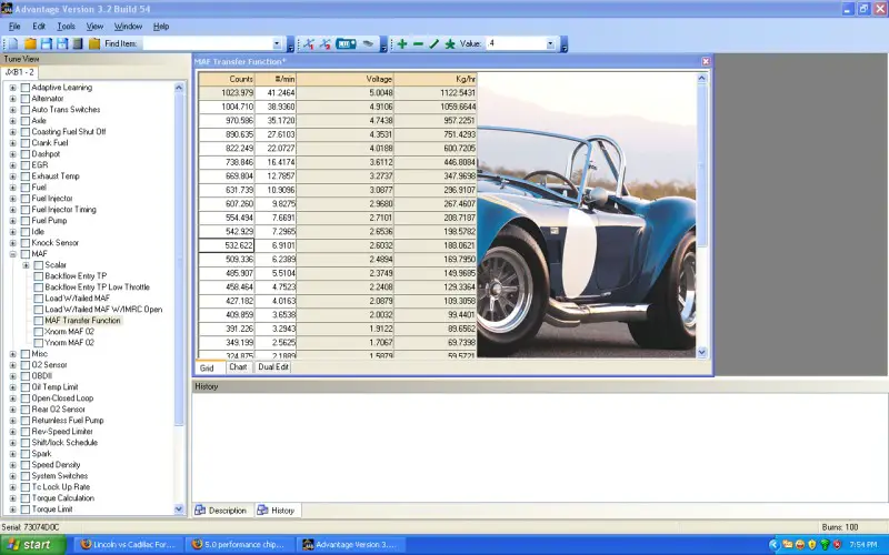

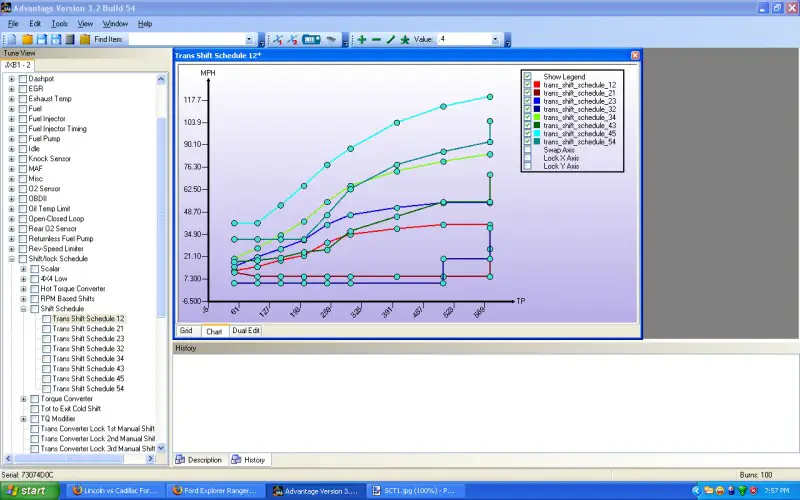

Here are a few pictures of the SCT Advantage tuning software. I have the MAF Transfer function open in one, trans shift schedule in another and the borderline knock table in the other. These are just 3 of many tables that is modified when tuning. When you get an SCT tune you get your money's worth.

Most of that looks pretty complicated, but some of the things could be pretty simple with some common sense and logic... but yea.... idk...
