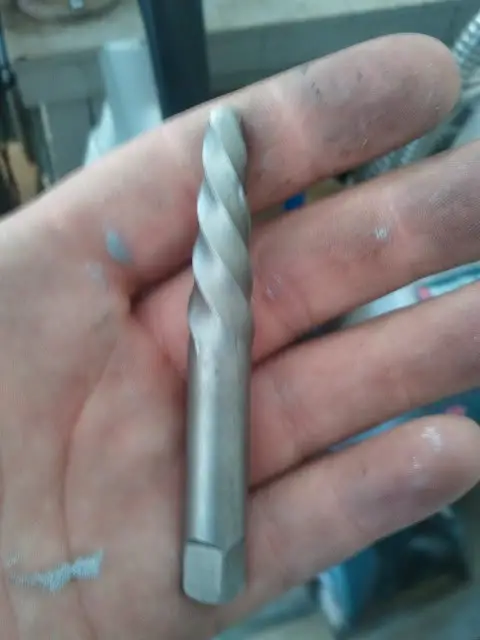

Yea my buddy works at Ace, he got the set for like 18$, it comes with drill bits, and like 3 different sized EZ outs.
We broke 1 plug after working and working on it, and then tried everything to get it out, nothing worked. We went and got this, and got it out in <2 minutes. The last plug was also hard, so we just cranked til it broke, and then got it out with the EZ out.
