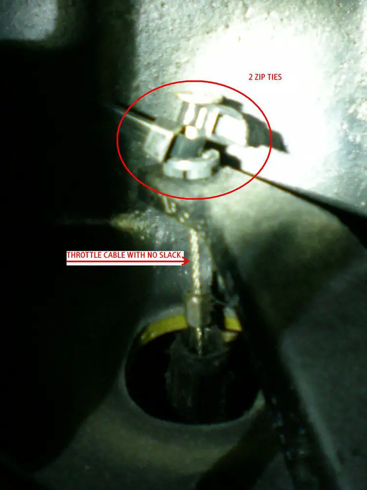

just did this mod. WOW feels like a whole new car! ;-)
I thought this was like some ricer mod, but the throttle response is just like before I had a lift.
Just did this to my 2001 XLS 4.0 SOHC and definitely noticed the difference. Its like having a brand new Explorer again!!
Thanks for the video!!!
I only had to use 1 ziptie, allowed throttle cable to meets its stopper, was immediately more responsive,m didn't mess with idle at all, and ttook intake hose of today and its almost completely open Like 98-99% open, and no more sputtering when I shift (woo standards)
Great mod. I actually noticed a small mpg gain since i dont have to jam my foot to the floor everything I'm on the highway. Thanks a lot.

You are all very welcome. Sorry ive been slacking on the vids lately. I have a lot going on. More vids to come!

Just put 2 zip ties on my cable and then drove around for a bit. Worked for me, response is so much better!! Best part of this was it was FREE and only took me 1 minute to do.

Any vehicle with a stretched throttle cable itll work great on.

yeah this is a super common mod on a lot of the ranger sites as well. i also have done this on my 05 focus cable.
First thing I did on my 99 Ranger when I bought it in 02, 'cept I used those retainers that look like horseshoes used in brake jobs-just squeezed them around the cable-been there ever since..not the first vehicle I've done this too..............
