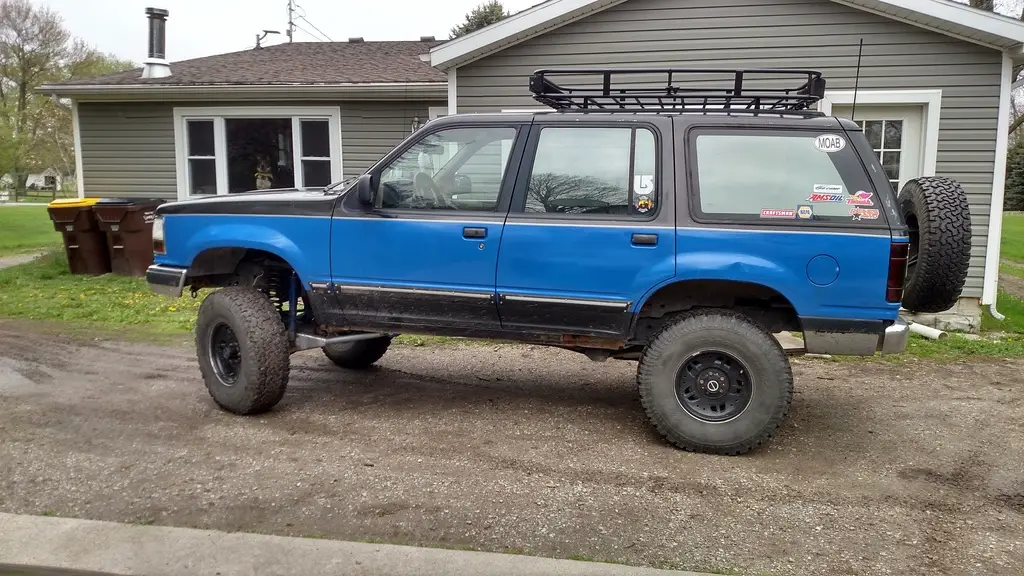

Front lift at the moment is 5" (4" coils and a 1" spacer). With moving to extended RA's and the F250 shock tower mod, I figured I should get a spring that is going to give me a compression and extension length that will compliment the previously mentioned mods...through some research, I went with a spring the provided the proper lift (or with a little extra in this case), provided a soft ride, and was flexy...
Whats your plan to keep camber under control if it is going higher?
The beam pivot points are as high as the cam bolt will let them go, so in theory, if I adjust them down with a longer spring on, it'll keep it close to good without having to adjust much...I have Moog adjustable camber/caster bushings to help dial it in again once it's done...call my uncle once it's done, put the truck on the alignment rack, and we'll be in business!

I was tired of working in the rain by 10pm, so I got the arms and springs on and left it like that...Sunday afternoon I got the shocks and sway bar hooked back up...
Sits with the back lower now, so I posted a quick message on Facebook concerning lift shackles, got two replies with Warrior shackle schematics and....
Just finished the second one earlier and they're getting some paint applied. Should have them on late tomorrow evening and an alignment is coming Thursday morning to take care of the camber and crazy caster! More pics will come (still have to do the shocks...this weekend?)
