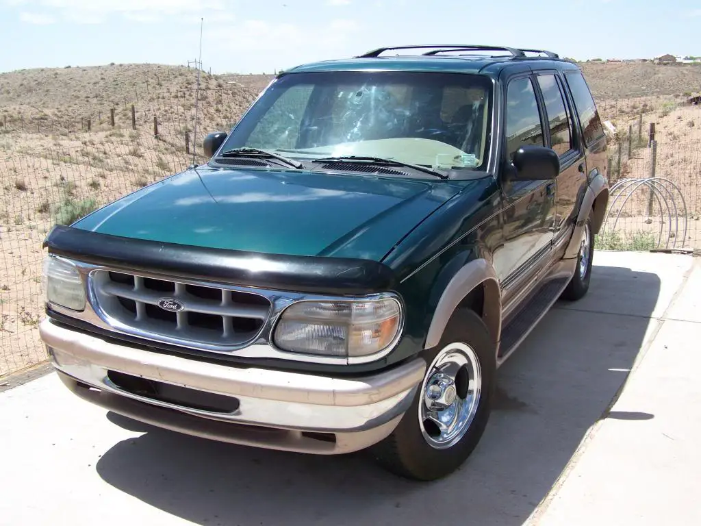

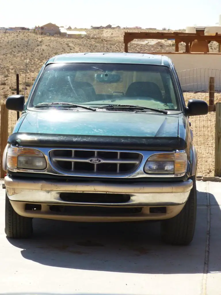

I might as well do some "before and after pictures" as well. Tell me what you think! Here are a couple.

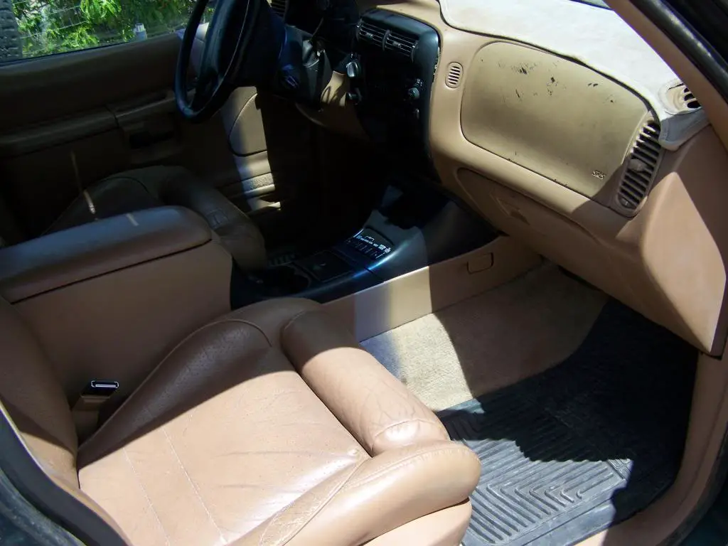

Here is the "after" photo gallery. Please LMK what you think!
