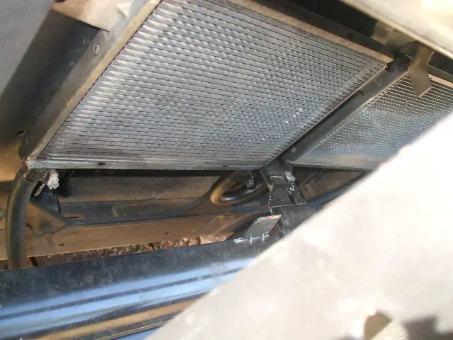

When I did my last trans swap , I Put a rag over the trans lines and used around 8-10 Psi with my air compressor to get all the old fluid out , I let gravity drain the stock aux cooler behind the grille and thats when I added a 2nd stock Aux cooler up front , you will only need one extra piece of hose if you install a 2nd fluid cooler up front , to run from one to the other , like this pic .
Edit : , You will gain some extra fluid capacity , as well as gain more cooling area . Its a win win if you have a local yard to get a stock one from for reasonable , I think mine cost like $8 .
Thanks for the recommendation. Would the symptoms of my ex be a bad tranny cooler? If thats the case le' time for JUNKYARD. :D
