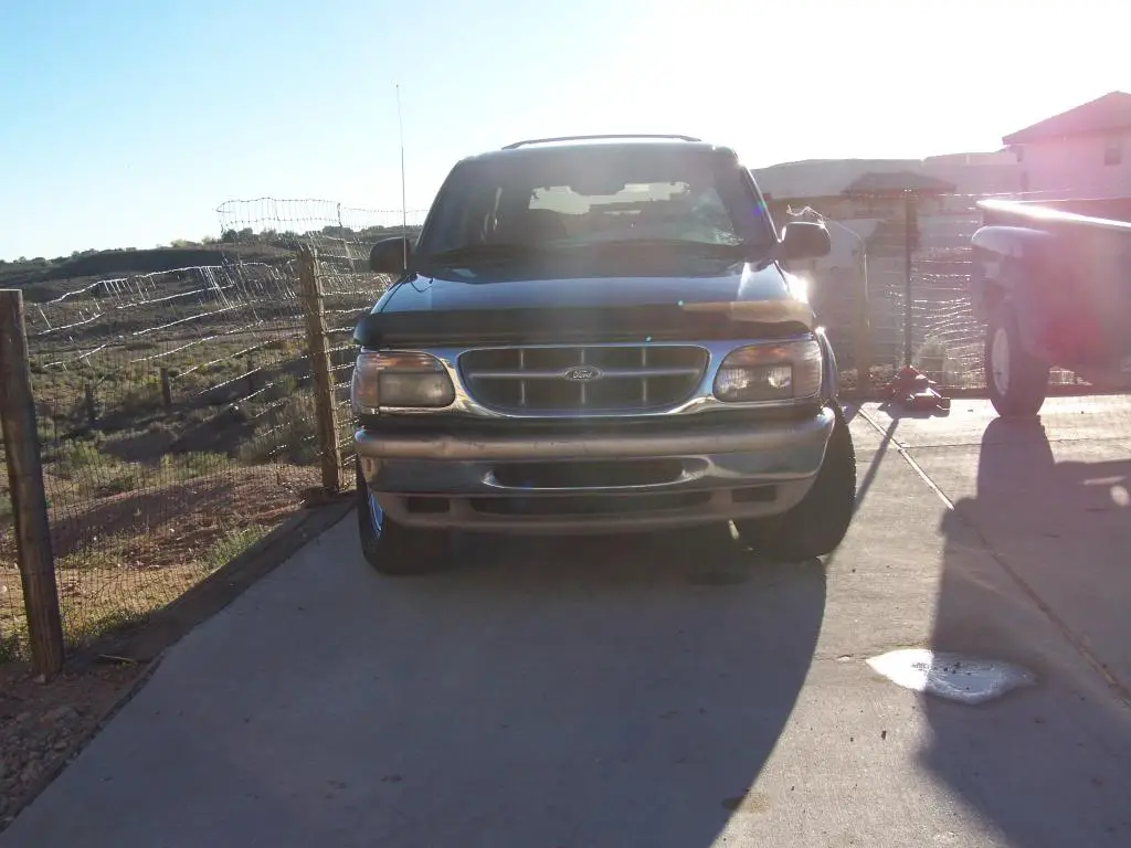

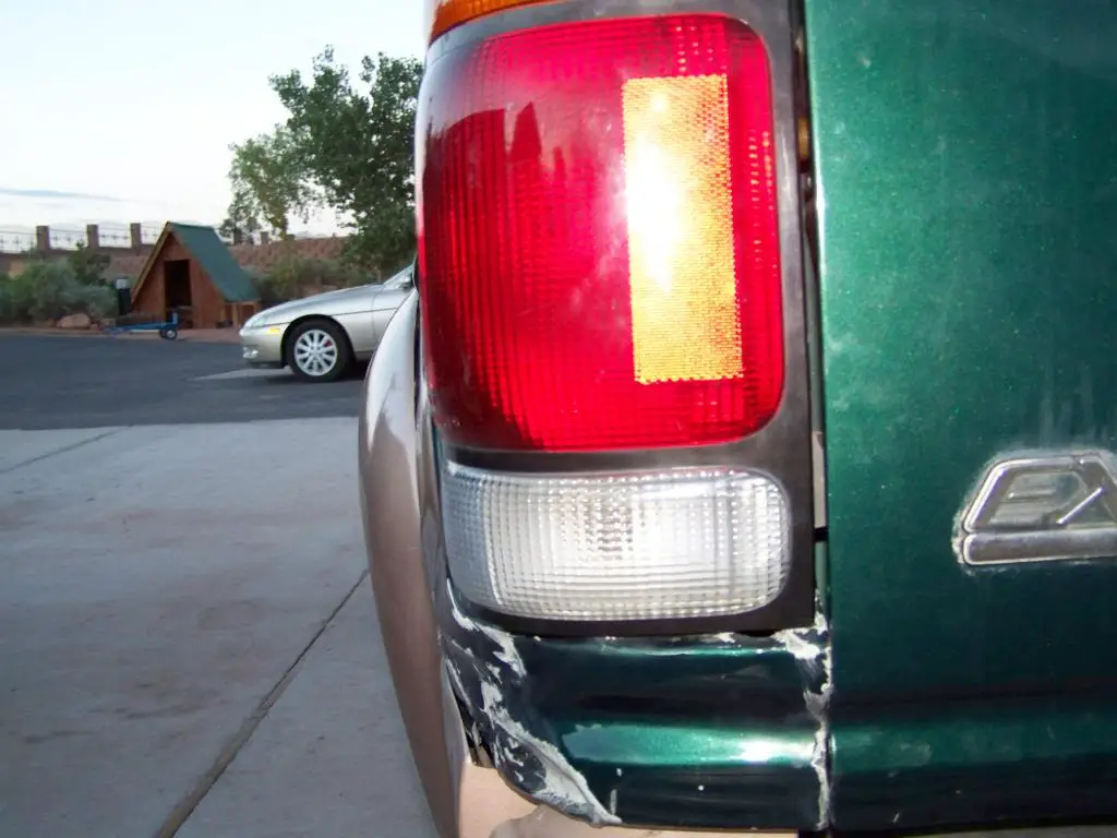

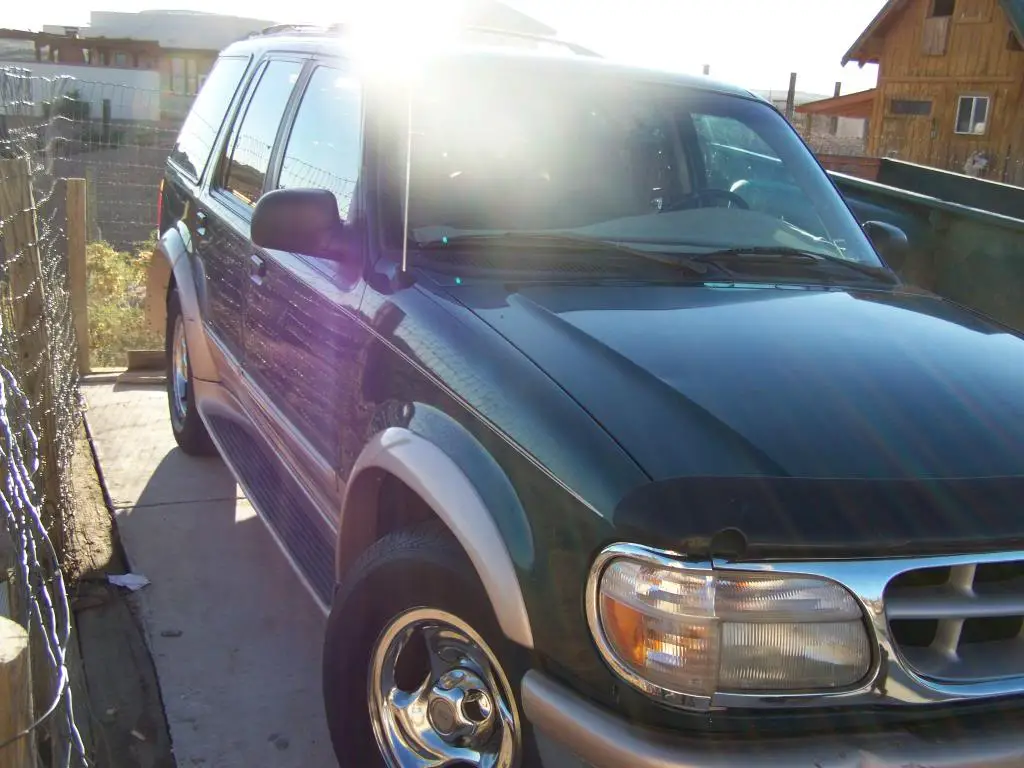

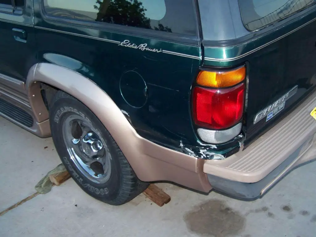

So...body damage is covered up nicely with fender flare. Will snap a couple pictures when I can. Fixed the radio switch. Very close and almost ready for sale gentleman.
I will clean and post up pictures so far. the before/after pics stuill make me wonder in awe and amazement...
Here's the pictures:
LMK whatcha all think about it...:)
Oh, and yes, I am going to touch that up with green forest eddie bauer painmt.
