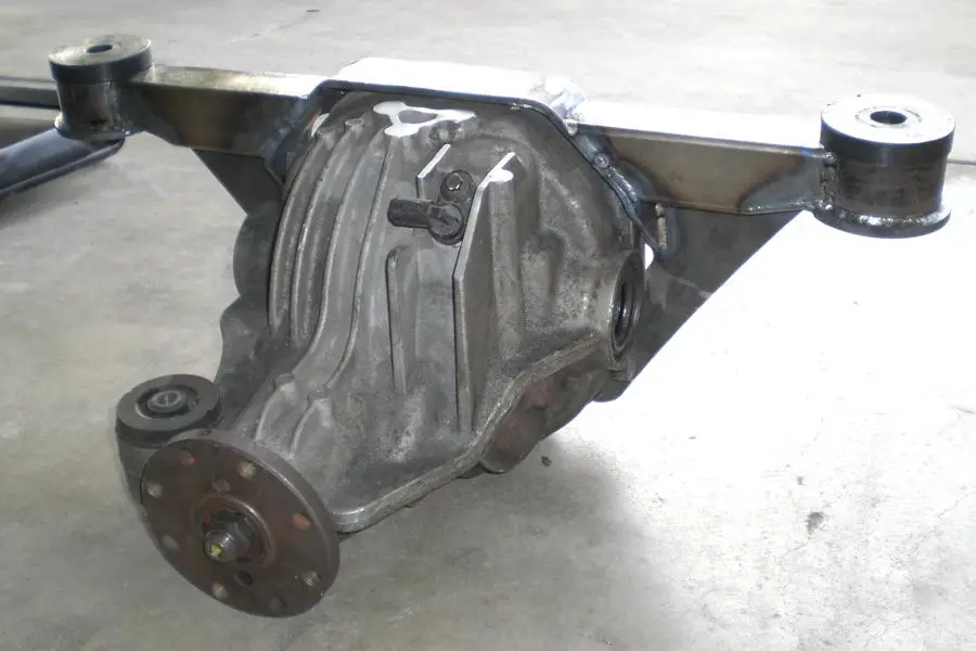

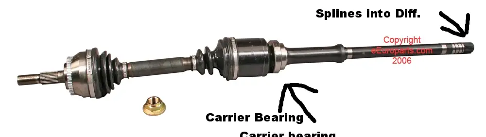

3rd gen explorers have 31 spline low pinion IRS in the rear. Could be run in the front when turned around backwards and be low pinion, but would need axle tubes or a support for the long side axle like a front wheel drive car long side axle. It possibly could be mounted like this off of the front cover bolts:

Ive been looking at different diff option too HighRoad. I like the lower stance that the A-arms provide and dont want to sacrifice it for a solid axle. Have you thought of the TTB D44. The TTB diffs were built to be self supported, easy to build a bulk head to bolt the housing to and into the stock points on the truck frame. High pinion I believe, so a plus if it fits. Probably could roll it over 180* if it didn't. The housings have a lot of meat on the axle shaft exit holes, easily modded for retainers/axle support - one side already has a support bearing in it. A few issues to sort out - like the long side shaft support at the A-arm pivot point, and sourcing said long side shaft.
