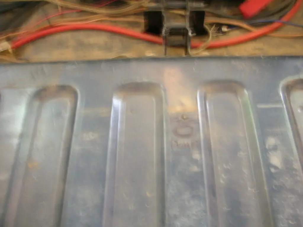

Fuel pump pictures:
Sorry fuzzy, best guess to cut location:
Looking from underneath, not much clearance above my tank pressure sensor, but there is enough:
small hole cut to see how close I was:
hole cut, pump removed, look how full the tank is!! would have been a bear to drop: I filed and painted the edges of the stock sheetmetal to prevent rust
pump, strainer and sender assembly:
custom access panel, blue one side, bed liner the other:
Made a seal using rubber hose and silicoln:
Done and done:
