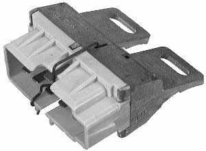

Yup, new switch, but the one that bolts on top of the steering column behind the dash (see pic), not the key cylinder.
It was what the burned up wire from the clutch switch ran to.
Any test to see if the key cylinder is the problem?
The key cylinder is what I was talking about. I have replaced those in my old '85 Ranger and a my dad's '93 t-bird.
I've got a new cylinder from my 90 Ranger you can try. Not sure if it will work, but it may be worth a shot.
