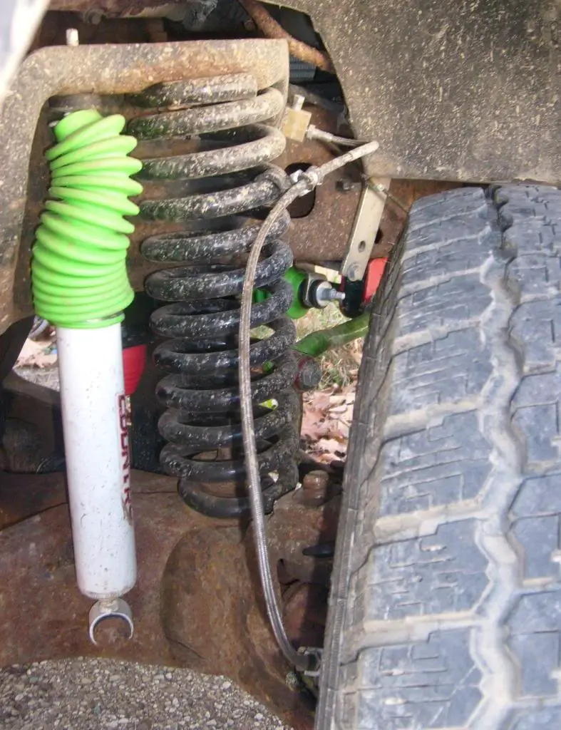

SwaintaN: your tie rod ens look WAAAAY much better than mine..... All my rubber pieces are long gone (well they're halfway there). Noticed them the other day while doing an oil change. Judging by the fact I still have motorcraft shocks on my truck, I'd guess the tie rod ends are original to the truck.
Waiting on the $$ to open up to replace, I don't need them to fall apart on me... the X is my only ride (<-- Oh lord I just said the x is my only ride.... ugh I'll pass on the "other meaning" of that)
the rubber pieces on your outer tie rods are dust boots, keeps them from breaking down quicker. Summit carries poly boots for like 6 bucks a pair. thats what i put on mine because the stock boots with my moogs that i put on just tore up even though they were new, rather pay 6 bucks now for new boots instead of new rods and alignment down the road.

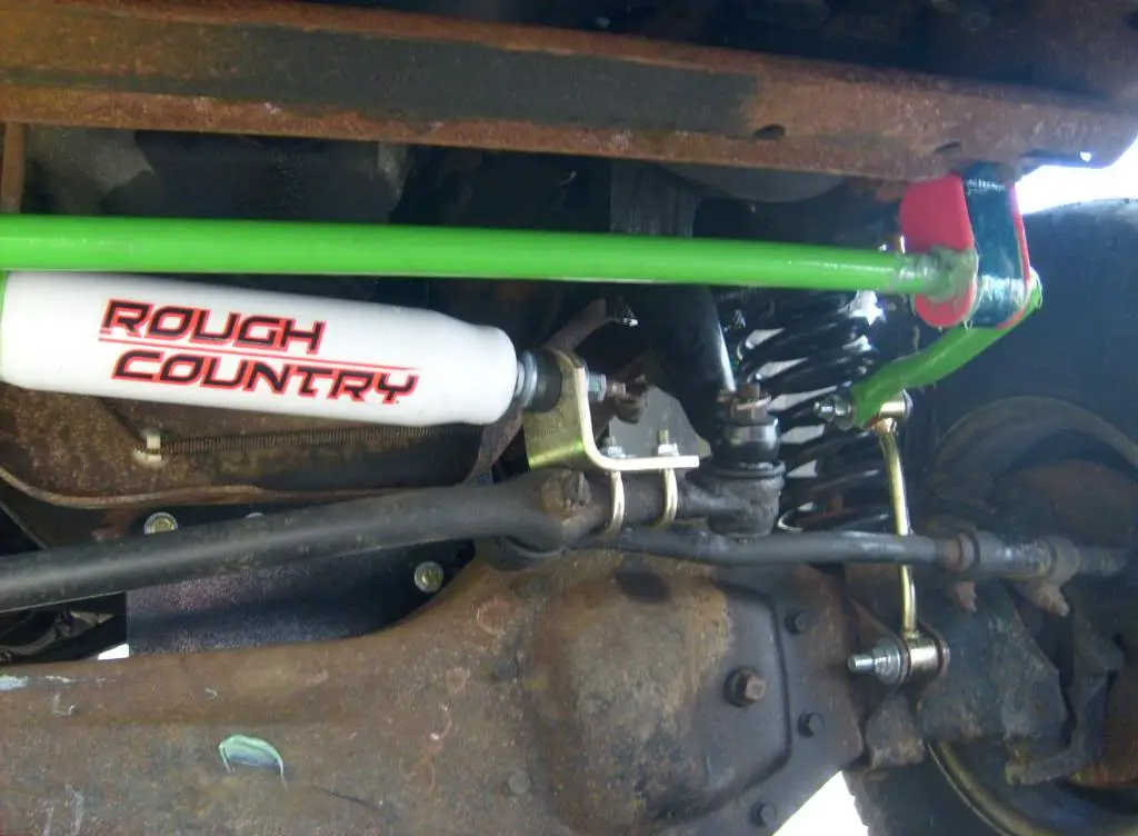

i wanted to clarify something really quick, i eliminated my rear sway bar because of RC lift wont let it fit, ive not seen a difference with it gone. when you lift though you will feel bump steer or a slight wobble feeling that is front sway bar, a steering stabalizer will stop that feeling, there is a couple different option for that one...
a single, like what mine looks like
a dual which is mine with two
and a single that is attached to the pumpkin which some others on forum use as well.
front sway bar will feel better to if you get the beefer poly bushings that require syn grease, you can get water proof syn grease from adv, its green about 10 a tube
Are those the factory end links for the sway bar. Plus on your steering stabilizer do you have any pictures of its set up and where it is connected. Thanks again.
ill put it this way, search on here for it on the forum. i am lifted, 4" rc lift w/ ws 151 in the back, 33x12.5 on 15x8 rims, front sway bar only, no difference.

front with the thicker red ploy bushings and syn grease

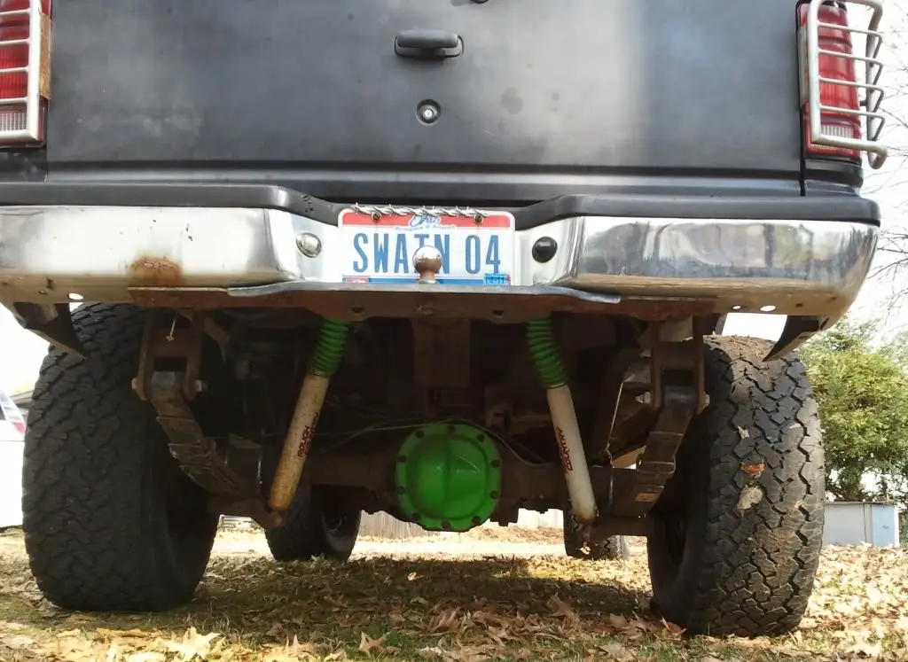

rear... gone... went to a friend for a custom build.
