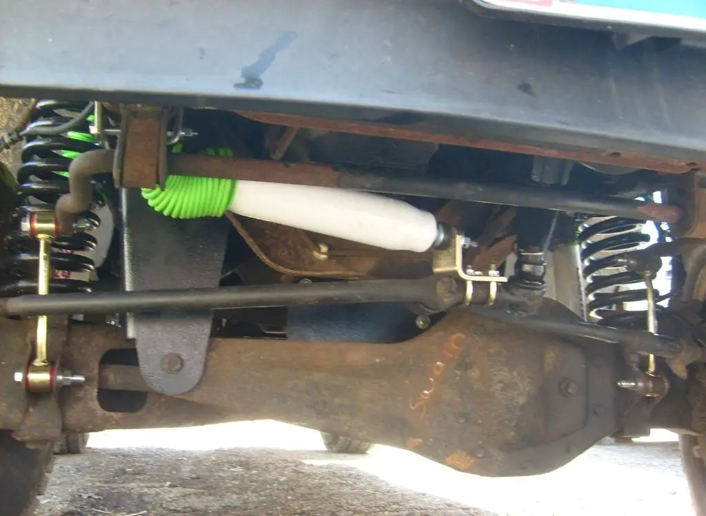

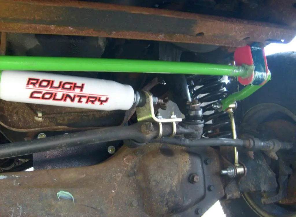

front with the thicker red ploy bushings and syn grease
rear... gone... went to a friend for a custom build.
