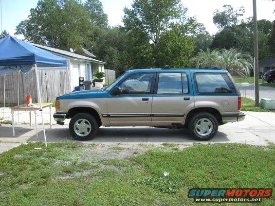

here it is when i got it...
here it is now..i had to remove the bumper because the right side was pushed in and rubbed the tire.
