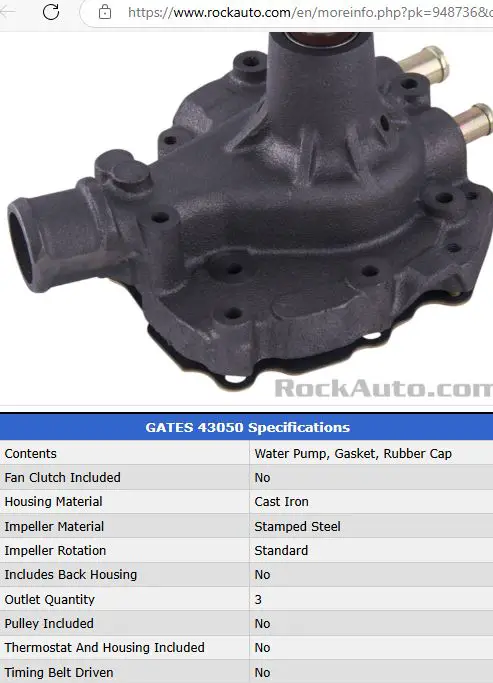

Does an '85 Mustang have a forward rotation water pump and is that one forward? I asked because you have your belt routed forward around the pulley.
I see what your saying. I can just run the belt on the opposite side to flip the rotation correct? I'm not even close to putting the motor in yet. Still have to drop the trans and bang on the tunnel. Then I can start to mock up motor mounts.
I was finding conflicting information as to whether the '85 Mustang has a forward rotating pump or not. The way that you are setting it up is good because you won't need extra tensioner hardware etc. I will look at some different '80s 5.0 water pumps. In the meantime, you
can pull the pump off and look which way that the impeller is designed to turn.
Ok. In 1985 a Crown Victoria with a 5.0 had a standard rotation water pump. In this Rockauto listing, there is a Gates pump listed for heavy duty applications like taxicabs and towing. If your pump happens to be reverse, you can use the '85 CV pump.
1985 Crown Vic 5.0 water pump
Please don't make me🤣 I really don't want to scrap all that silicone away I used to gasket it.
A small camera thru thru the hose port to see the impeller works without having to remove the pump from the engine.
