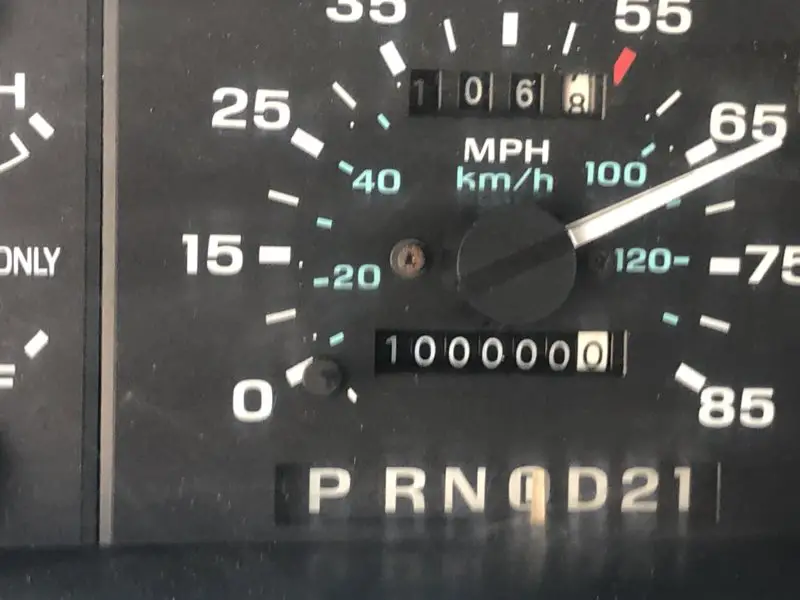

The numbers don’t lie, almost 17 mpg lifted on 33’s with the horrendous automatic transmission tach reading 2500 rpm’s in overdrive at 60 miles per hour. I’m impressed, and now I wonder how much better it will do once I get the manual transmission swap completed, and have an extra gear to drop the rpm’s some. While the extra gear won’t drop it much, I will welcome any drop I can get.

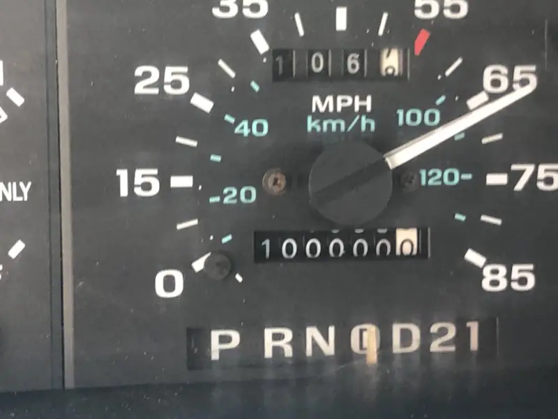

No the speedometer is not fixed by a new gear on the vss. That number is straight from the speedometer app on my phone. The speedometer reads 66 or so to get the speed I recorded. I honestly wish it would tach lower as I’m not a fan of higher rpms on the highway for engine life.

5 over with that combo isn't bad really, but I would still get the VSS gear swapped out to correct those shift points.
The P/O must have swapped the VSS gear, to get it that close. I'm going to guess a black 20 tooth is in there now.
Can't remember (on 1st cup of morning coffee) which size is made after a black 20 tooth, either 21 or 22, but one of those would work. $5 fix, so it's worth it for fuel savings alone, while you wait for the manual swap to happen.
