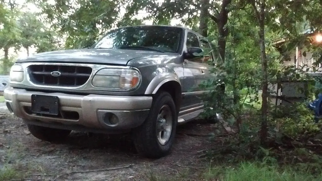

So, I dug up a photo I put online, it's back when I bought it, it's been detailed since then.
