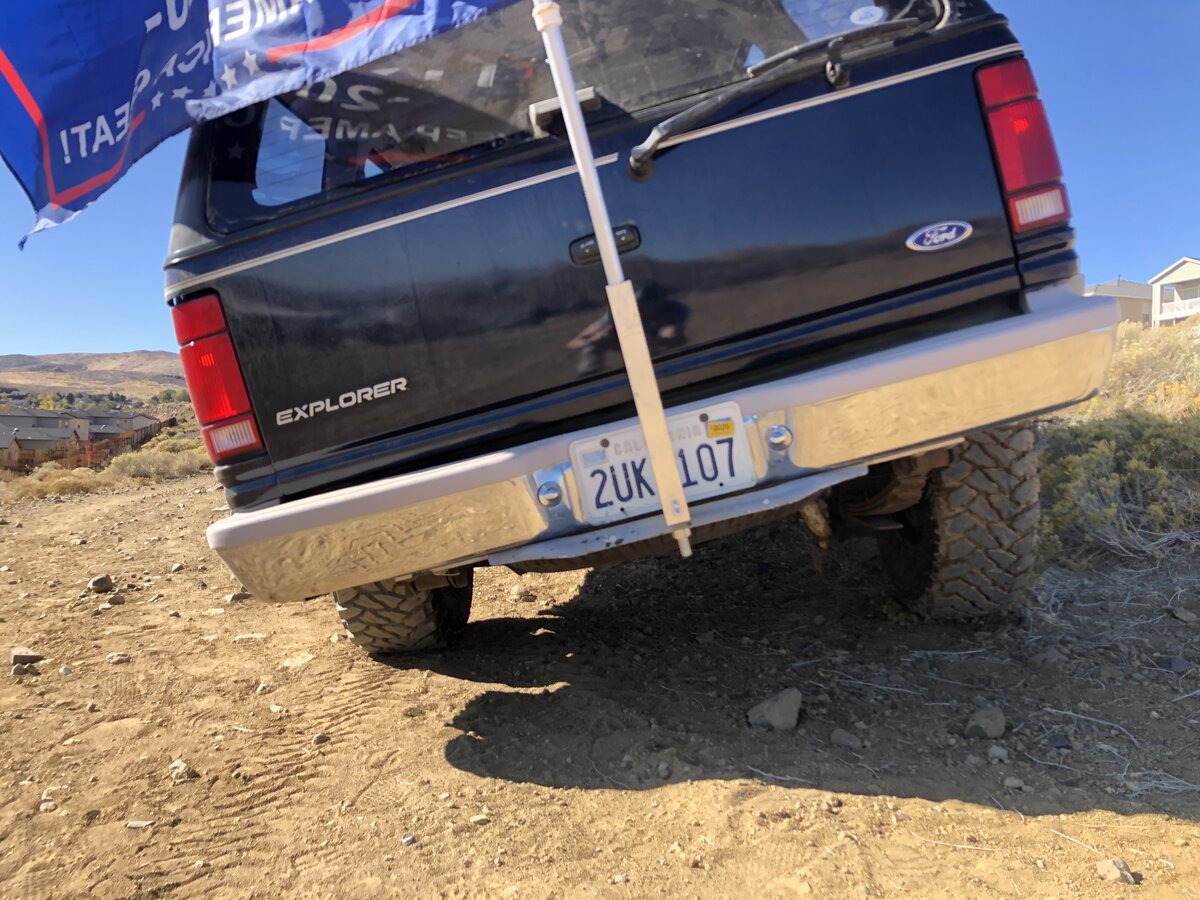

8) I removed the ball on the rear bumper for towing and replaced with a simple flag mount system. It is easily removed and swapped with the original ball if I need to tow a small trailer one day. ($15)

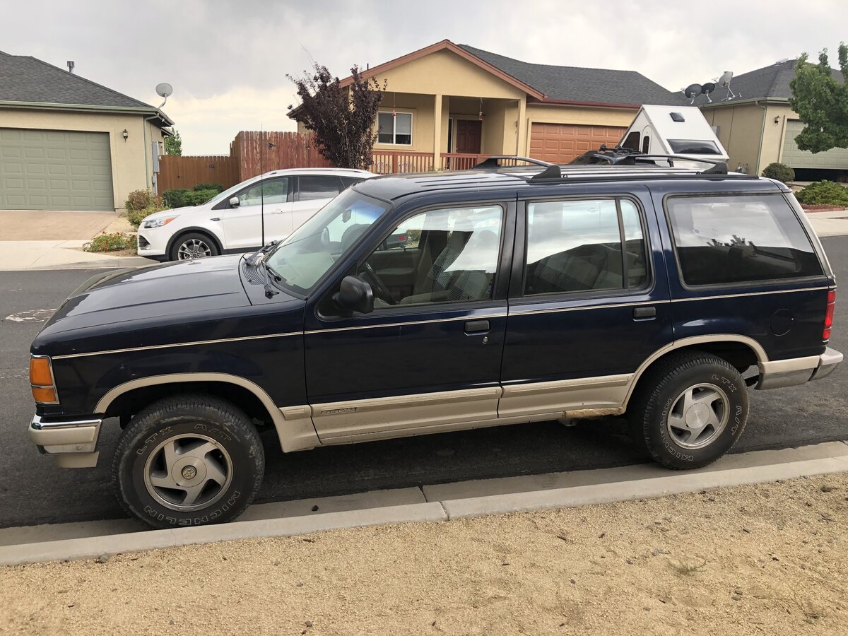

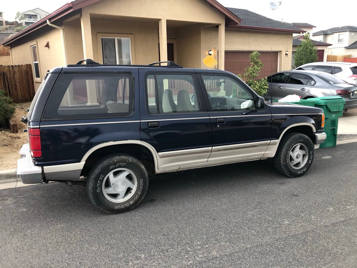

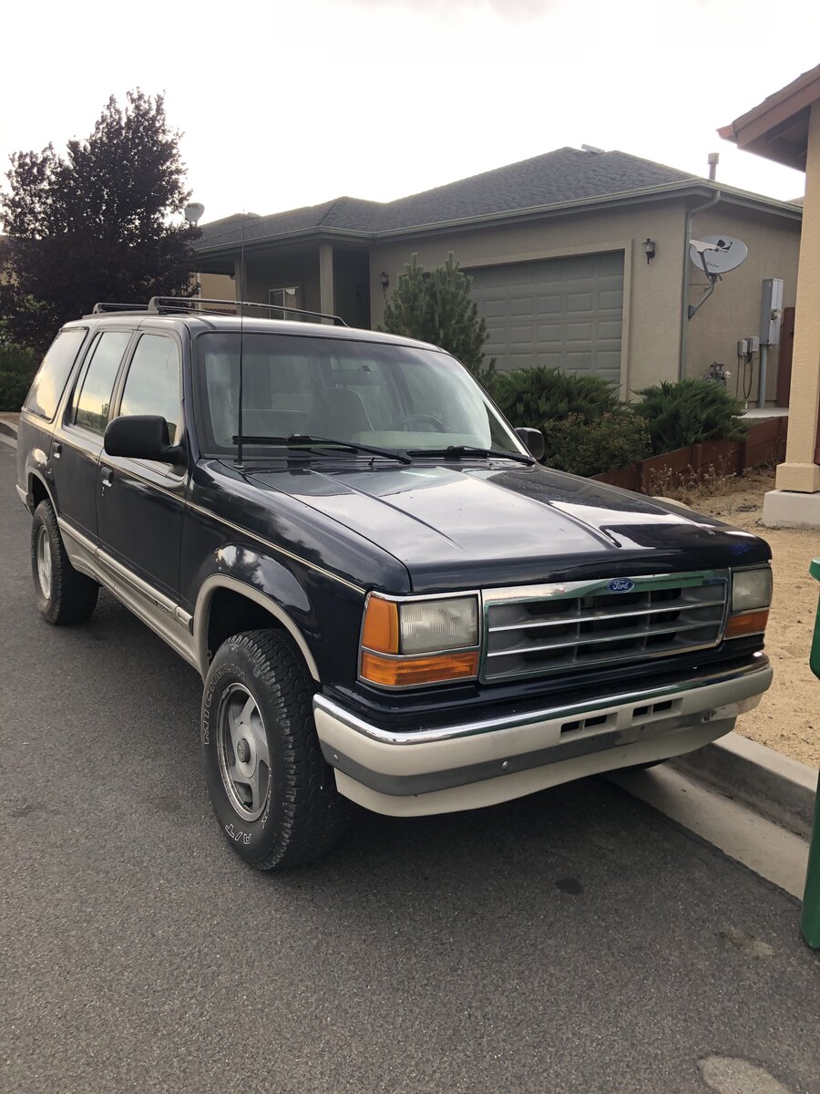

The day I bought the EX

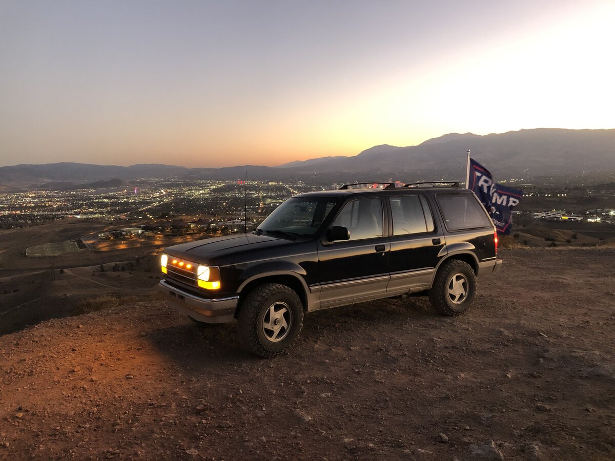

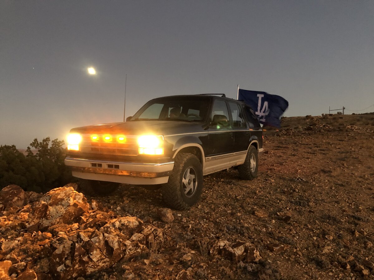

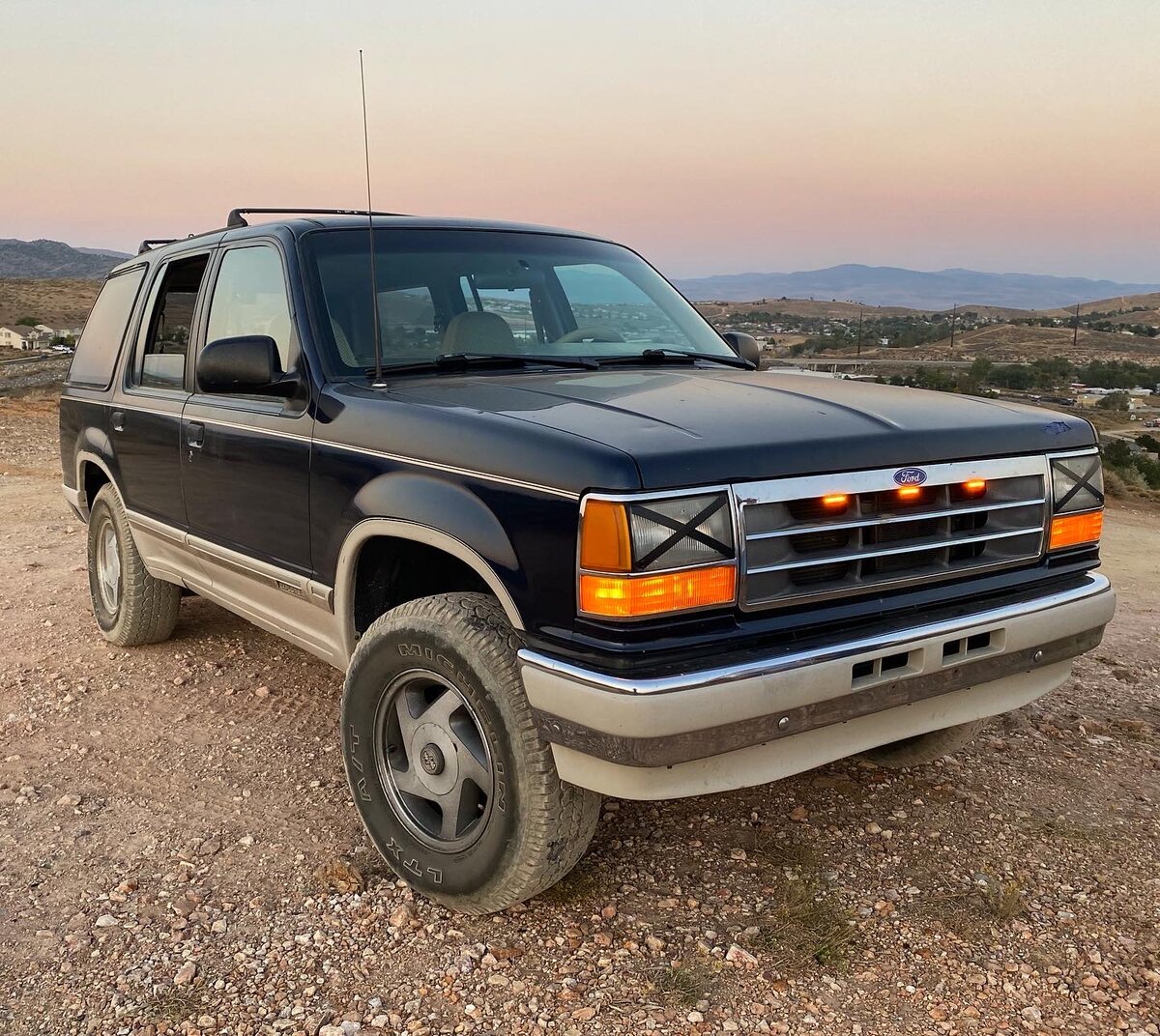

After installing amber grille running lights. (12V)
This was a fairly easy task. I ran the positive and negative lights through a hole I drilled in the firewall just to the upper left of where the brake peddle is. I then ran under the lip of the panel under the steering wheel to the directly under the stereo. I sobered the positive and negative to a cigarette 12V cigarette lighter and when I drive all I do is plug in the cigarette lighter in and they turn on. I taped the headlights with electrical tape to mimic my favorite rally car driver (Ken Block) who exclusively drives fords so it seemed fitting! These amber lights are very bright. The pictures don't do justice but they are far brighter than the amber running lights under the headlights.

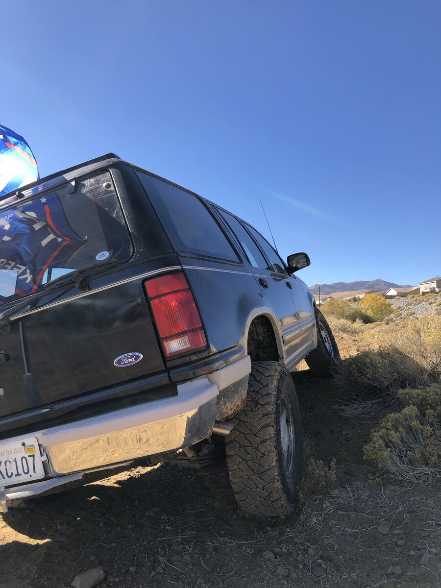

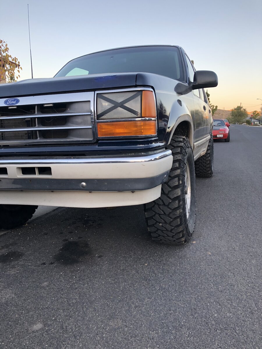

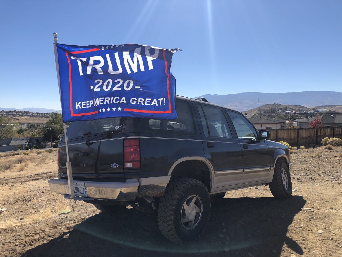

After installing new 31" Tires.
Kept the stock rims. The shop warned they would not fit without rubbing. The only rub I experienced was at full rotation with the plastic air dam under the bumper. I cut off about an inch and have not had any further rubbing. I went with Kendra Klevers. Note, these are mud terrain and they will cause your Ex to pull with the angle of the road. I thought at first it was causing the vehicle to pull to the right so I marked with tape to see how much I had to correct with the wheel and then drove on the left side of the road. I marked with tape and they were equal, so not ideal for driving on the street (I don't mind it), however makes all the difference off road.
** I also swapped the front tires and rear tires from side to side to see if it affected the pulling before driving on the other side of the road. No difference whatsoever. They also seem to pull more when slowing down, less when accelerating. Not sure why this is but just something I noticed.

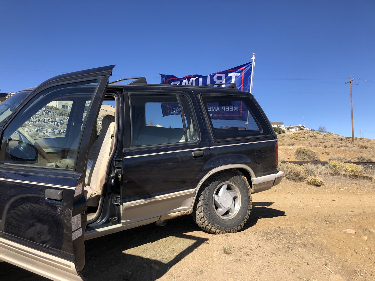

Interior Pics
The interior was in pretty great shape when I bought it, just filthy. I deep cleaned everything and aside from the speakers being **** and the door panels needing a bit of work, it cleaned up great! you can also see the switch that I have put in for the amber running lights in the grille, they are now hooked into a module that has buttons to control what is on or off. I also bought some cheap seat covers just because I'm sometimes pretty dirty after camping or shooting, but the seats underneath are in almost new condition.

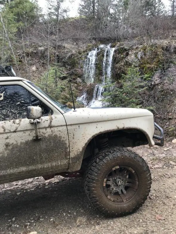

Off-road pics so far..
You can see that I'm still getting great movement with the tires with no rub with no lift and 31" tires. Impressed with the capabilities of this EX. It has gotten me virtually everywhere I have taken it. Uphill on loose rock, approx 40 degree inclines with absolutely no problems. I just take it slow, no need to break parts on the trail IMO.
